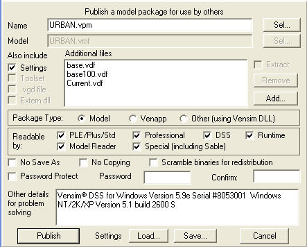

The difference between"publish a model package for use by others "and"executive file builded by venapp installer builder"?

Publishing a Venapp will allow it to be opened from the Vensim Model Reader. In order to do this the user will first need to install the Vensim Model Reader. If you create a packaged application that will put together both the model and the Venapp engine at the same time. In that sense it looks more like a typical application.
