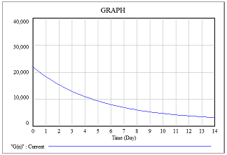

I have tried to model this using vensim. I modeled this formulation:
"G(n)"= G 0*n*exp(-k*n*Time)+"(G r)"
Using the above formulation I get a negative exponential graph, which is different from what I need to get. I attached the model together with the result that I want to get. I am not sure which part of my model is wrong? anyone can help please?

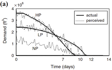

I forgot to add the graphs. I add them to this post.
- Capture 1.PNG (10.2 KiB) Viewed 5937 times

for some reason, I cant upload two pictures in one post. I add the result that I want to get to this post.

Yes, calibrating parameters will not generate the graph that I want. The descriptions are the authors response to my email regarding how to model a disaster demand.

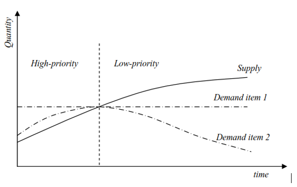

Graph that I want to match shows the solution of his model and I realized that it’s actually “wrong” to match the model output to this graph. The question still remains: how to generate a disaster demand? Based on my understanding from literature, the function should produce the following graph:
p.s: The graph comes from the following article. I am not able to upload the full article here as it is not permitted. Here is a link to the article:
Quantifying communication effects in disaster response logistics: A multiple network system dynamics model
https://www.emeraldinsight.com/doi/full ... -2014-0031
The paper presents a discrete mathematical system dynamics (SD) model to study the role of communication and logistical coordination between actors in an emergency disaster response operation, and to measure their impact on the number of lives saved and dollars spent.
The author response to my email after not getting a similar results from the model:
"Figure 2a in the paper shows the solution of the model. To obtain it, you must input the user-defined parameters (such as the function G(n) you chose) into the model, and solve the model.
I am not familiar with Vensim, but you can solve the model using any software that can solve a system of recurrence relations (you can even use Microsoft Excel for example). Equations 6-14 are the recurrence relations that define the variables in terms of their value at the previous time step. The solution of this system gives you the curves that appear in figure 2."

it looks like parameter "n" actually refers to "time". so previous formulation was wrong. the new formulation for G(n) is:
G 0*Time*exp(-k*Time)+"(G r)"
it shows an overshoot and collapses behavior, but starts from an initial value of 0. this is wrong based on my understanding. demand at the onset of a disaster is a value greater than 0. so I think this function can not be used for demand in disaster.
would you please help? How to generate the graph for "item 2" using a SD function?
