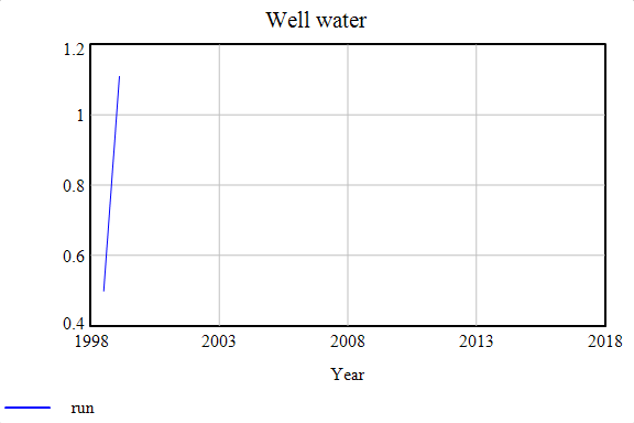

I have given time series data as input to my variables. The data is annual in nature. I have set the time step to year in initial settings of the model. However when I am trying to plot the variable it is observed that the values are plotted with an interval of one month. How to rectify it?

I am attaching model, excel data and graph of one of the variable.

- well water data.png (6.33 KiB) Viewed 11648 times

The Year column in your spreadsheet is not numeric, it's text. I'm not sure what Vensim is assuming about the time axis, because you haven't provided the equations or imported .vdf, but I'm guessing that if you fix the timing it will work.
