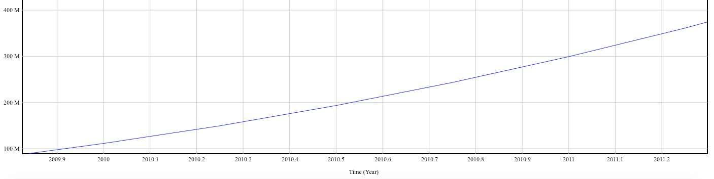

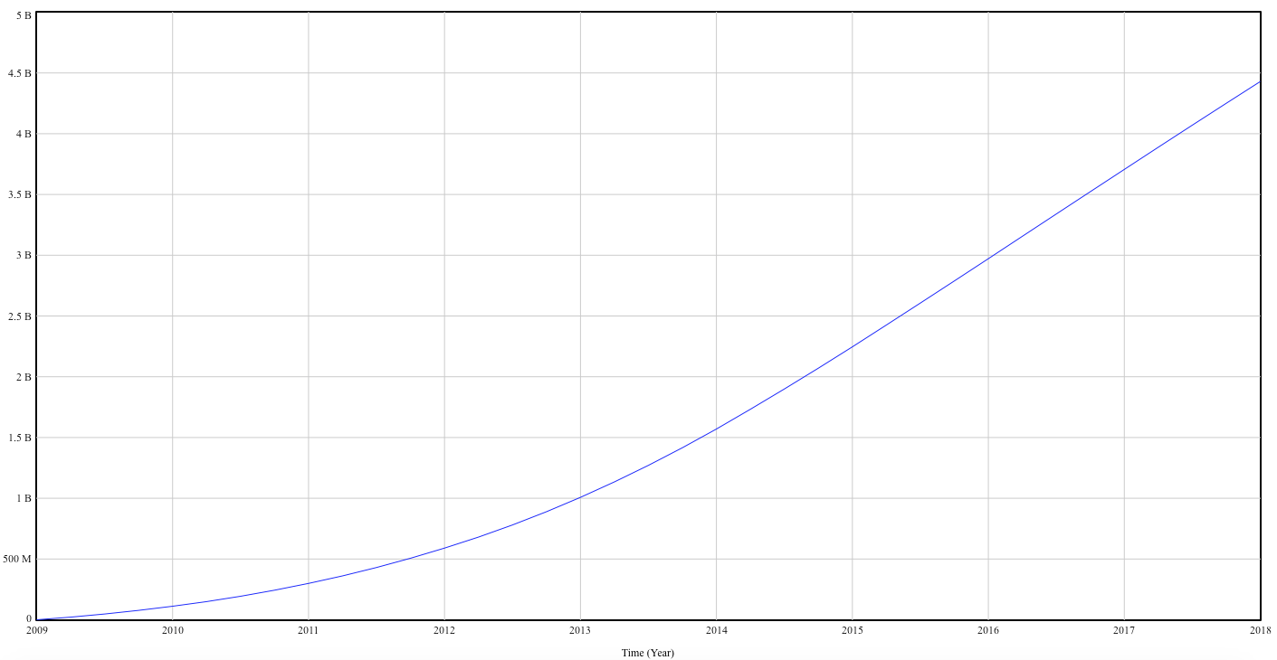

Here is the file I am using as input, and its output with a 0.25 timestep. There are two stocks accumulating equally so the result should be the input divided by two. As you can see from the closer screen shot the result is wrong. If timestep is set to 1 then the output is as it should.

Re: Stock Accumulation
Changing time step to make something look correct indicates an error in the model.
Here are some guidelines on selecting a suitable time step.
http://www.vensim.com/documentation/ind ... e_step.htm
Have you looked at
http://www.vensim.com/documentation/ind ... mulate.htm
I think this is what you need (along with the correct time step for your model).

I think you need to look into more detail at the data equations.
Between data points, Vensim interpolates the data. For example, the value used for "TOTAL number of app store and google play apps" will be interpolated between the two yearly points which is why the total accumulation is not correct.
I think if you use :HOLD_BACKWARD:, the numbers will match what you expect.
http://www.vensim.com/documentation/ind ... ations.htm
