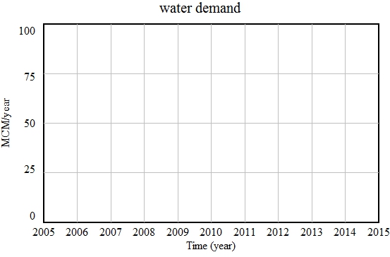

Hi Guys,
I'm a new with the Vensim. I would like to know where I am wrong, because I plot the chart but the line does not appear.
I have attached the image.
Thanks,
Posts: 3988
Re: I plot the chart but the line does not appear
What do you get if you use the table tool?
wanderbeg
Posts: 20
Joined: Mon Mar 18, 2019 3:21 am
Post by wanderbeg »
I want to get a graph / table showing the total demand for water (Urban demand + irrigation).
Quame
Posts: 26
Joined: Tue Mar 12, 2019 7:37 pm
Post by Quame »
Are you reading any time series data from excel?
wanderbeg
Posts: 20
Post by wanderbeg »
Quame wrote: Fri Mar 22, 2019 12:24 am Are you reading any time series data from excel?
Irrigation data are time series.
Quame
Posts: 26
Post by Quame »
If you are using GET DATA function to import the time series data, then this is the cause. VENSIM does not recognize excel dates. A way I found around this is: in the model settings select a base date (when time =0) to correspond to a date prior to the first date in your excel. Then number the dates in your excel from say 1 to 100. Your initial time under model setting is 1 and final time is 100. Enter the same values under the control panel. Check time as date in the control panel and that should fix it. I am assuming with the above configuration that your time step is say day and your dates in excel are continuous, ie no missing date.
Quame
Posts: 26
Post by Quame »
Let VENSIM read the numbers rather than the dates
wanderbeg
Posts: 20
Post by wanderbeg »
I modified the comma in the numbers of the irrigation database and got the graph with the row / table with values. However, it did not add up to the urban demand, ie the water demand graph is only with the irrigation data.
Posts: 4832
Can you upload the model? It's impossible to really help with just screen shots.
wanderbeg
Posts: 20
Post by wanderbeg »
I've been able to solve the problem. Problem of standardization of the comma.
Thanks,
