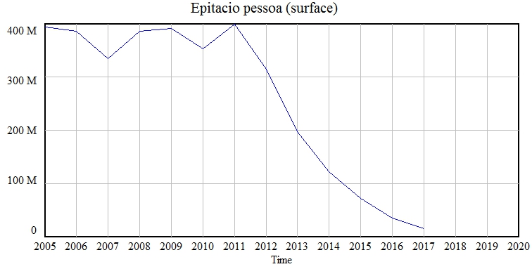

Here's how, I have historical reservoir level data from 2005 to 2017, but I want to do simulations by 2020. I put this time (2005-2020) in the model settings in vensim.
What happens is that the line does not touch the "0" point of the x axis.
I know the reservoir level will not reach water until 2010, but I was wondering how long it will have water.
Note: I'm new to Vensim.
Help - please
Help - please
- screenshot.654.jpg (82.6 KiB) Viewed 2465 times

You'll need to upload the model, there is nothing we can do with only a graph to look at.
Re: Help - please
Is this a data variable? If so, the line won't extend past the end of the data.
