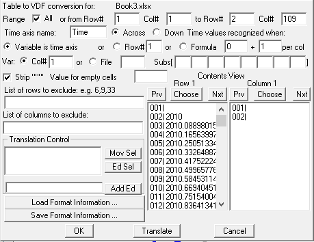

Hello everyone,
I try to import database into Vensim, it awalys report an error said Unable to parse the data file.
The reason might be that when importing database, Vensim did not recognize the data's name.
But, in the excel, the name is set. I have tried many times and it still doesn't work.
So I was wondering what's wrong with that?
Forgive me for asking a very simple question.

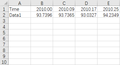

Administrator wrote: Thu May 07, 2020 12:05 pm Can you upload the Excel file?
Input.xlsx
(11.51 KiB) Downloaded 755 times
This is the Excel file
Posts: 4832
Re: A question about GET XLS DATA
I managed to get it to import. Edit cells A1 and A2 and delete the ' from the start of the cell. Save and now try importing.

Posts: 4832
ok, that spreadsheet has some extra info attached to the cells A1 and A2 which are causing problems when importing. It will be fixed in the next release.
If you edit cell A1, the contents are 'Time, delete the ' from the start of it.

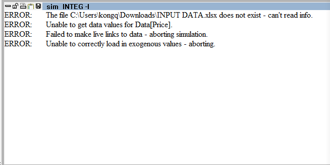

It doesn't work, report same error.
Posts: 3988
If it's reporting "does not exist" you probably have a path error. Change the equation to GET XLS DATA('?mydata', 'Sheet1' , '1' , 'B2' ) and it will query you to locate the file when you run the model. (Be sure that it's not open in Excel, because Excel locks the file.)

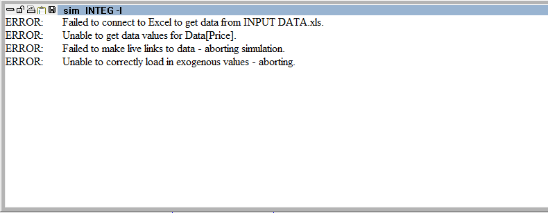

tomfid wrote: Thu May 07, 2020 7:44 pm If it's reporting "does not exist" you probably have a path error. Change the equation to GET XLS DATA('?mydata', 'Sheet1' , '1' , 'B2' ) and it will query you to locate the file when you run the model. (Be sure that it's not open in Excel, because Excel locks the file.)
When running the model, excell will be popped up, then report an error.
Said Failed to connect Excel to get data from INPUT DATA.xls

Posts: 3988
I'm disenchanted with the cloud versions of Excel, which seem to get flakier with each update. I've switched my GET XLS protocol to Direct (on the Settings tab of Tools>Options). That makes GET XLS work like GET DIRECT. The downside is that the file can't be open in Excel. The benefit is that these problems don't happen, and you don't have to have Excel on the target machine at all.
