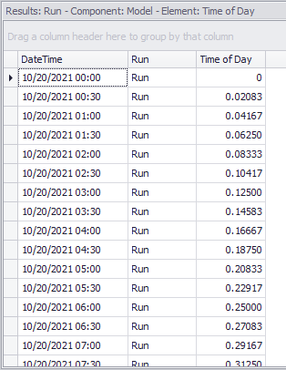

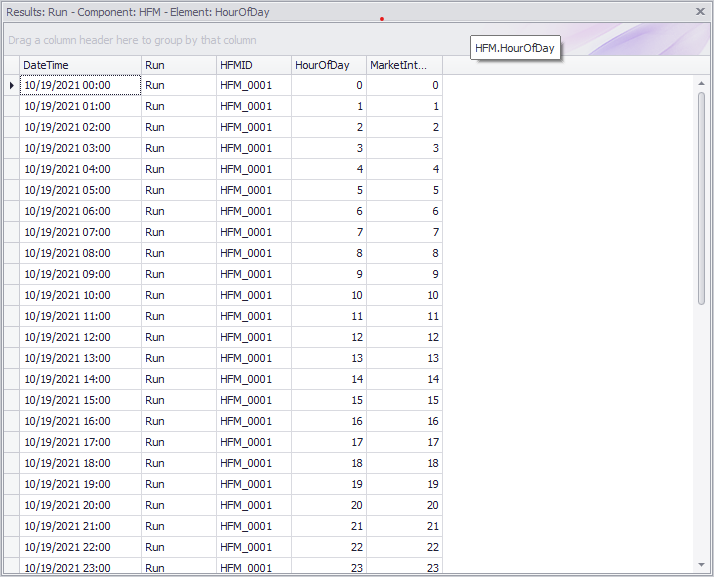

Thanks. I also need to work with higher frequency time intervals, e.g. every half-hour. Is there a way of integrating that with calendar time too? For example, instead of showing hourly subdivision for each day (see below) is it possible to show 48 subdivisions in DateTime to show the half-hour intervals?

Ok, thanks. Seems obvious now that you pointed that out. I managed to get what I needed - namely a repeating index to use in a lookup table.
To achieve that for a 48 interval day with each interval being 30 minutes, I dialled in these settings:
1. Run Control: Time Step = 0.02083333 (i.e. 1/48), Unit of Time = 0.5*Hour
2. Defined an auxiliary "Intervals per day", Units = 0.5*Hour, Equation = 48* Time Step
3. Defined an auxiliary "Time of Day", Units = 0.5*Hour, Equation = Modulo(Time, Intervals per day)
Note that using Time Step in 2. was required to get the repeating index.
I have attached my simple example model in case this helps someone else.

I think there may be some unintended consequences to this.
0.5*hour isn't understood as a time unit. The calendar algorithm seems to be defaulting to days as a result. (since time = 2 at the end of the 10/21-10/22 interval).
Units checking is likely to have trouble later, because a unit with the * operator in it will be interpreted as (0.5)*(hour) - not sure a "0.5" will be understood.
If you want one time unit to be half an hour you could name it something like HalfHour, but I'm not sure the calendar time algorithm will recognize that.
I would instead set Time Step = 0.5 with time unit "Hour".
