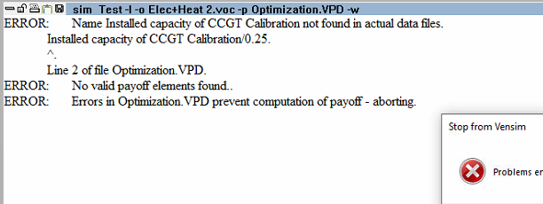

I am trying to calibrate my model.
According to the Help in the Vensim, I have imported the data in the model.
And The payoff of Calibration and All the parameters of Optimization have been set.
But, When I run the model, it shows the error.
I was wondering what's wrong with it?
Thank you very much!

It may be that you haven't told Vensim to use the data file. Try simulation control, and the data section. Or run the optimization wizard and make sure you specify the data file in the last step.
Alternatively, can you upload the files so we can take a look?
