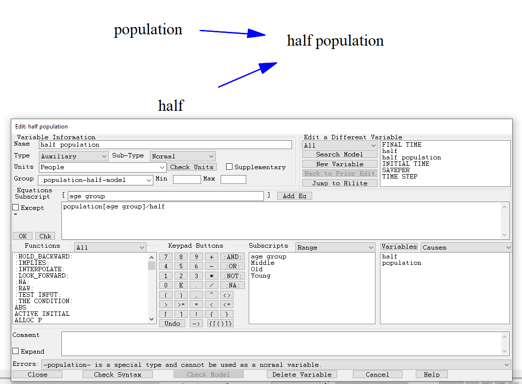

Hi, I have the same problem, I would like summing some subranges of subscripts. Could you share an sample model?
To first try to get something simpler working, I tried just dividing the population lookup values by some constant. Then, I get an "is a special type and cannot be used as a normal variable" error.
What is the recommended way to read or process such data that I can use is normally?

I missed that I needed to input TIME into the lookup to get a single (range) of variables. Now that I fixed that, I also got the sum working.
cortneyg, if you are still looking how to do that, here's an example model.
