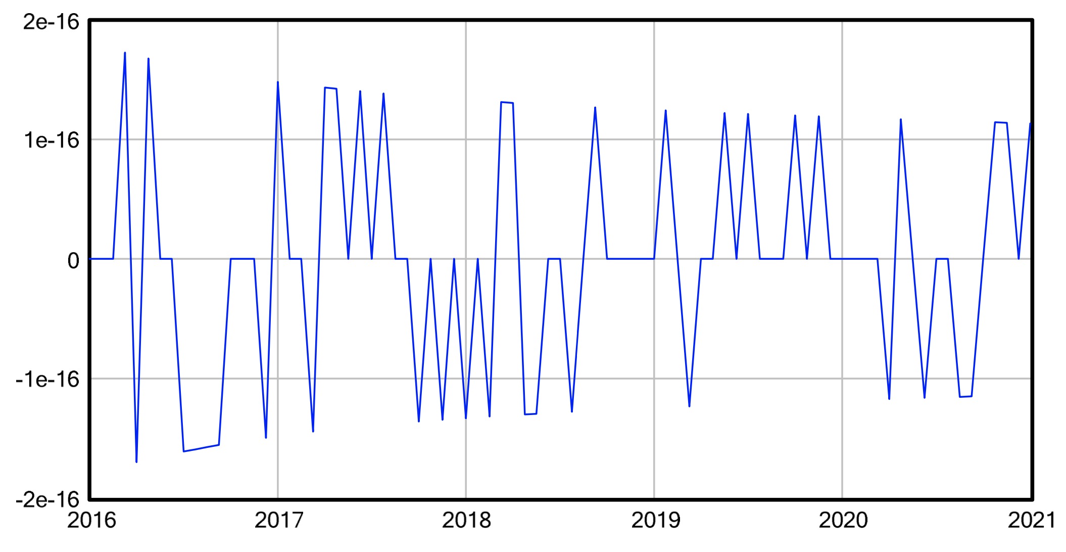

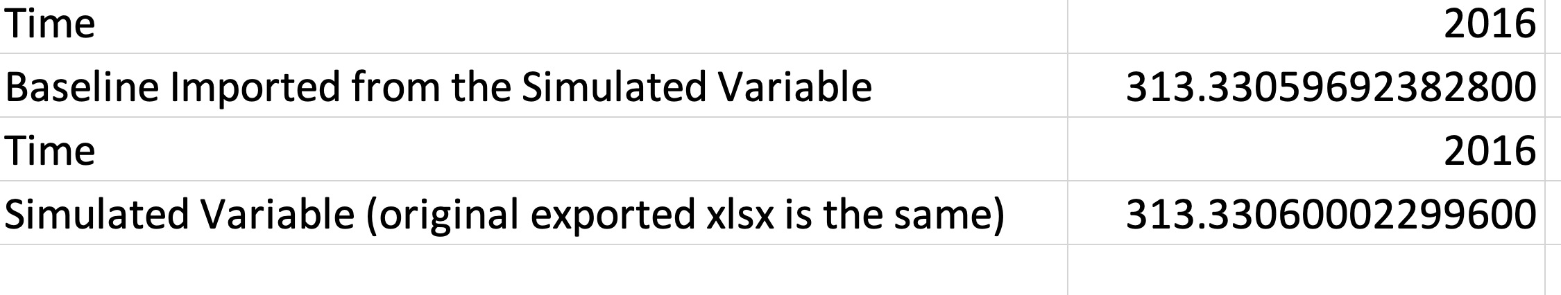

I have the same issue on Vensim DSS 9.3.5. I want to compare the impact of different strategies with the baseline values. I exported the simulated values into xlsx and imported them again as data values, but it slightly changed the imported values. Then, I exported the new results for both original and the baseline values. The original one remained the same, but the data values were changed.
After spending a lot of time (I am more familiar with the first method for importing data), I realized if I read the excel file through the GET XLS DATA function, the error is reduced to e-14, which is desirable compared to the larger error I get with the Import Dataset method.

Re: Fractional error?
Could you please test it with the structure I posted here? A test excel file and a test Vensim model would work. I used 313.33060002299600 as data input. Please let me know if it does not work, so I will send the exact files I have used to make this example.
Thanks - we'll take a look. My guess is that it's a numerical precision truncation somewhere. But it's probably impossible to fully reconcile - Excel's numerical storage is presumably a decimal format, while Vensim is using doubles. As I recall, the IEEE standards even permit variation in the low bits beyond the standard size, which may arise in different hardware.
Does this have any policy relevance in your model? If the results are qualitatively sensitive to these differences, it's either an interesting situation, or an unreasonably sensitive formulation.
- Posts: 215
Yes, it can be a sensitive formulation (unfortunately, I am unsure if I can share the model, as it is part of a larger project). I wanted to use a shortcut to calculate the percentage change from the baseline. That is how I realized the imported baseline dataset (captured from exporting the simulation output) differs from the simulated baseline (the graph). The error is extremely low when you read the data using GET XLS DATA (the red parts in the image show the data export/import process. They are not model variables).
