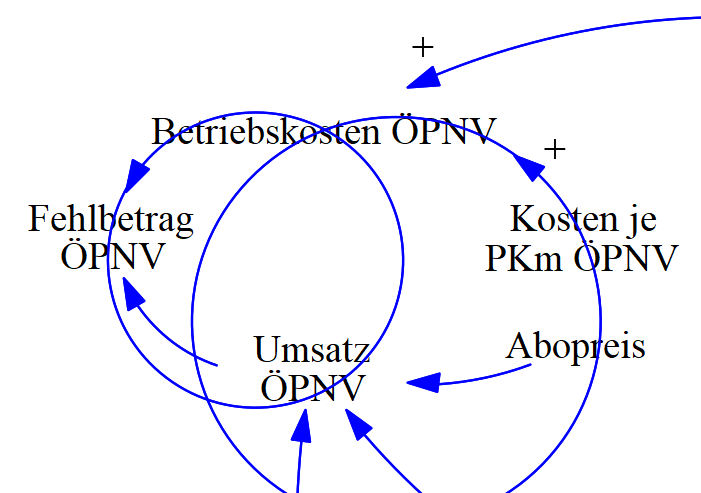

EDIT: The problem described above might be related to the following: I've been setting up a new laptop and moved files over from the one I've been working with so far. However, when I open existing project files, the design of the sketch sometimes gets strangely adjusted (see attachment). These circles seem to appear when linked elements are placed too close to each other, which might also be caused by the clear boxes being too big. In this case, text also looks smaller and/or the gaps between elements are larger. I assume this all can happen when you work with different Vensim versions and different settings. However, wouldn't it be helpful to have a more standardized design, also bearing in mind that you might share project files with team members?
Maybe I'm missing something... I'm looking forward to your help!

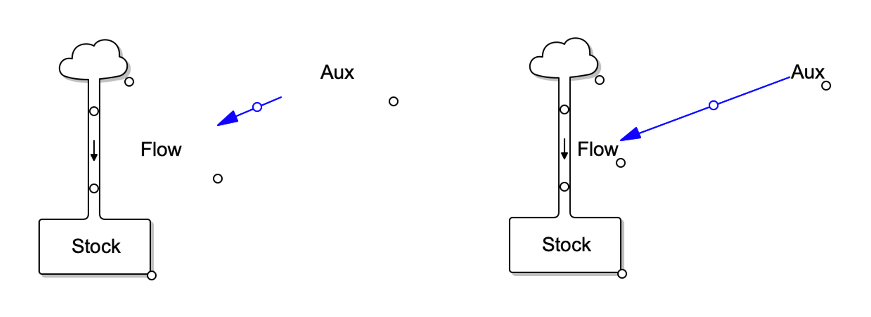

I can confirm I see the same behavior on Vensim 9.2.4 on PC and Mac. I create a new test file as below on left. When I close and reopen Vensim, I see the figure as below on right:
Sometimes the bounding box has no height at all (shadow variables? I haven't yet reproduced the conditions).
I agree with MarvinK, suggestion you do NOT to recalculate the bounding boxes. Unless you recalculate the bounding box exactly as it looked before I closed and reopened Vensim, I consider the new bounding box to be wrong.
