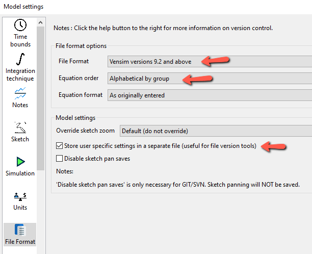

Are you using the new file formats in Model>Settings?

Aha! I have been using the old GUI, which doesn't have these options when I go to Model>Settings. I am gathering might be the issue here since these options aren't available.
I can test more tomorrow using the new GUI and settings above.
