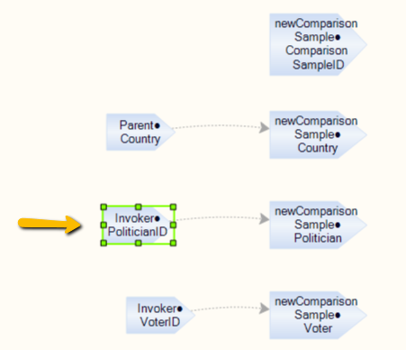

I created a new action Create One Sample Record in Politician. Then, in the voter’s Create Sample Records action, I edited the trigger to call refPolitician.Create One Sample Record.
Looking at action owned by Politician, Create One Sample Record, the Invoker was Politician. That’s wrong and the app is in an inconsistent state. When a trigger calls an action, why isn’t the Invoker automatically set correctly and is unchangeable? Perhaps because different entity type invokers can call the same action. But there is no way to manually set different invoker Entity Preference while a simulation is running, so only one setting is realistically possible, if I understand this correctly.
So on Create One Sample Record, I changed Invoker from Politician to Voter. This action is a Create. Now I was able to set all three surrogate attributes needing setting.
But now I get two errors: “Generated code at (1078, 83) 'GeneratedCode.ozjCAxcBJL.voter' does not contain a definition for 'politicianid' and no extension method 'politicianid' accepting a first argument of type 'GeneratedCode.ozjCAxcBJL.voter' could be found (are you missing a using directive or an assembly reference?) (context: creating; create new comparison_sample reference, in action_create_one_sample_record_voter)”

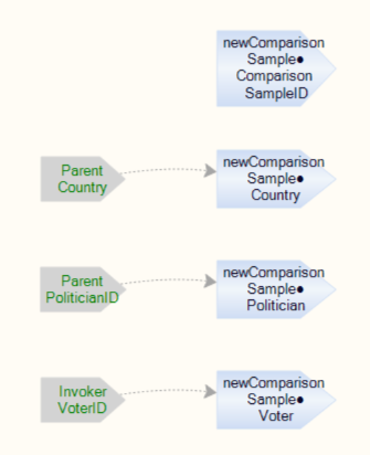

The proximate cause is that you're using Invoker.PoliticianID to initialize the politician attribute in the Create One Sample action.
I'm guessing this happened because you did the following:
- create the Create action; since it's in the Politician, Parent=Invoker=Politician
- start initializing the newComparison... states
- inadvertently grab the PoliticianID from the Invoker
- later, remember to change the Invoker type to Voter
At this point, the Invoker.PoliticianID surrogate is invalid, but Ventity doesn't catch that, hence the generated code error. Very easy mistake to make.

That fixed the problem. Your guess as to the procedure for how it happened is correct. <lament on> But still, I would expect Ventity to keep itself in a consistent state when a user enters a value for Action to Invoke, just like it does when you rename entities, etc. Otherwise, there are too many things for a user to do manually. After all, this is a declarative language.<end lament>

Re: How to create one Comparison Sample record
Thanks so much. That solved the problem. Now I've encountered two problems.
