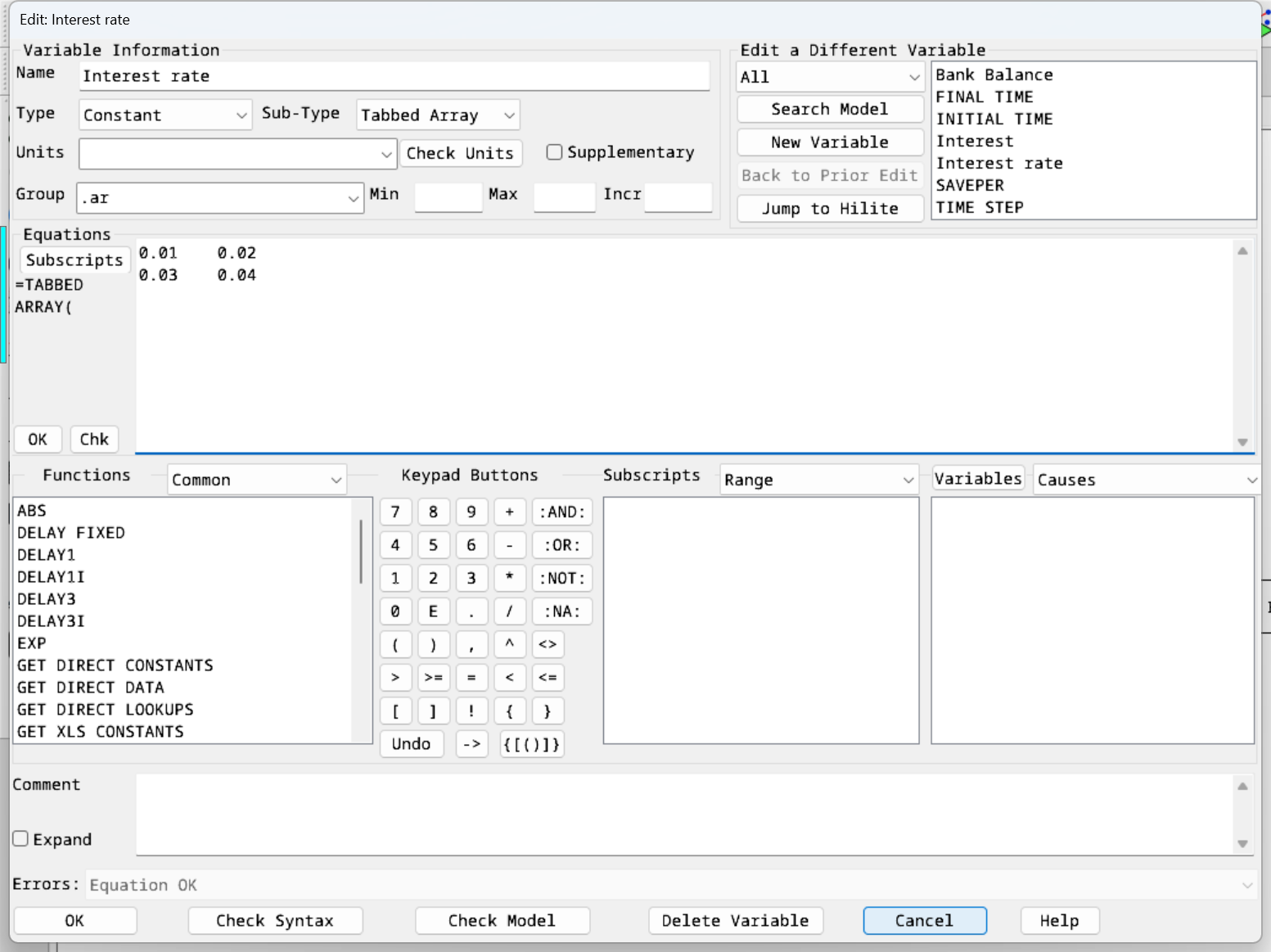

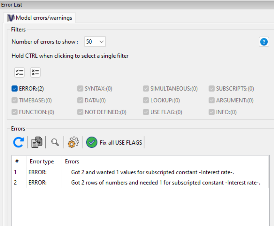

I am currently seeking some assistance with the use of the tabbed array function in Vensim Pro. I'm trying to build a simple interest rate model to evaluate the impact of varying interest rates on a bank balance. I've been attempting to utilize the array function, as shown in the attached picture, but I've been receiving error messages every time I run the model.
Function equa.png (201.7 KiB) Viewed 2391 times
error list.png (121.86 KiB) Viewed 2391 times

I just noticed that the equation in your screenshots doesn't have any subscripts. That's why it's not working - you're supplying multiple values for a single variable.
Click the "subscripts" button in the equation editor and add some dimensions to the variable.
