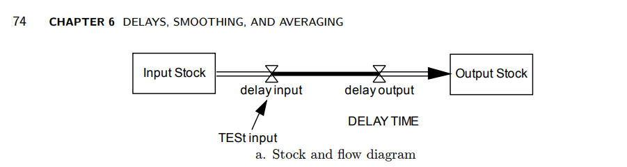

I found picture of stock and flow diagram with a two valves in it's flow, in ch.6 System Dynamics Quick by Kirkwood p.74. I've attached the picture, and we can also access through this link: https://www.public.asu.edu/~kirkwood/sy ... o/ch-6.pdf
how to make a flow diagram like that in Vensim PLE software? thank's before

I've uploaded a video to show you how to do this.
https://youtu.be/4J8_Zyp2D4w

Great, perfect..
thank you very much..
