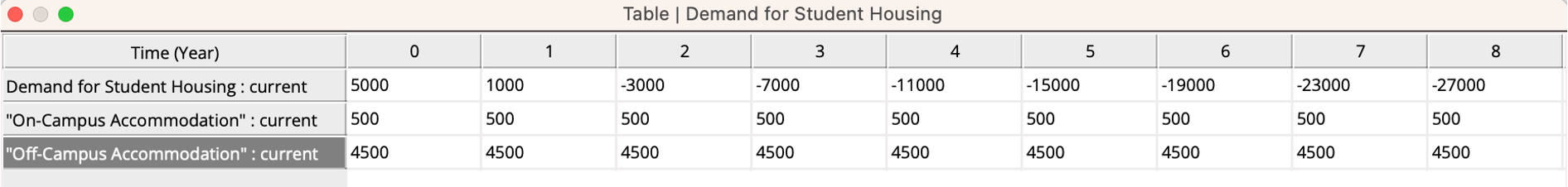

I have a question about a simplified Vensim stock and flow diagram and would greatly appreciate your help!
Background:
I would like to demonstrate a stock "Demand for Student Housing" with an inflow "On-Campus Accommodation" and an outflow "Off-Campus Accommodation.
Values:
Time measured in Years
Demand for Student Housing initial value = 5000
On-Campus Accommodation value (fixed) = 500
Off-Campus Accommodation value = 4500
On-Campus Accommodation is a fixed value based on campus amenities available. Off-Campus Accommodation would increase depending on the overall Demand for Student Housing (this depends on the number of enrolled students, but I have left this out for simplification and to demonstrate my problem). But let's believe the above values are true for any years to come.
Problem:
When running the simulation, everything seems neat in "Year 0" based on the above values. However, when looking at "Year 1", it appears that Vensim carries over the initial value (here, "5000") to the next year and incorporates it into the result. I do not want to carry the initial value into the next year as it falsifies the demand I want to demonstrate.
Question:
Is there a formula that incorporates a time element saying that if the current time is greater than Year 0, the initial value is set to 0? Or even a formula that I could add that always resets the initial value from Year 1 (and following) to 0?

I have attached the .mdl file as well as a screenshot of the diagram. I also reworked the results in Excel and uploaded the file, which makes it very clear that Vensim takes the demand from the previous year into account when calculating following years.

Re: Stock & Flow: Initial Value Issue
It might be best to start with a tutorial in Vensim before attempting this. That would help with the understanding of the difference between stocks and flows.
http://www.public.asu.edu/~kirkwood/sysdyn/SDRes.htm
On this page you will find a really good Vensim PLE tutorial.
I think you've got things wrong conceptually. The "demand for rooms" can be a level, it would increase with the "number of new students" each year, and decrease by "students finishing their courses".
"On campus accommodation" is probably a constant. Or maybe a level, it increases with "new on campus accommodation built", and decreases with "on campus accommodation demolished".
"Off campus accommodation" would then be
demand for rooms - on campus accommodation.
This is not a problem, it's the definition of a stock or level variable, which represents accumulation. With Euler integration,Husky123 wrote: ↑Sat Jun 24, 2023 12:46 pm Problem:
Stock(t+TIME STEP) = Stock(t) + TIME STEP*(inflow-outflow)
As Admin suggests, reformulating the model with stocks of students and housing is a good solution.
