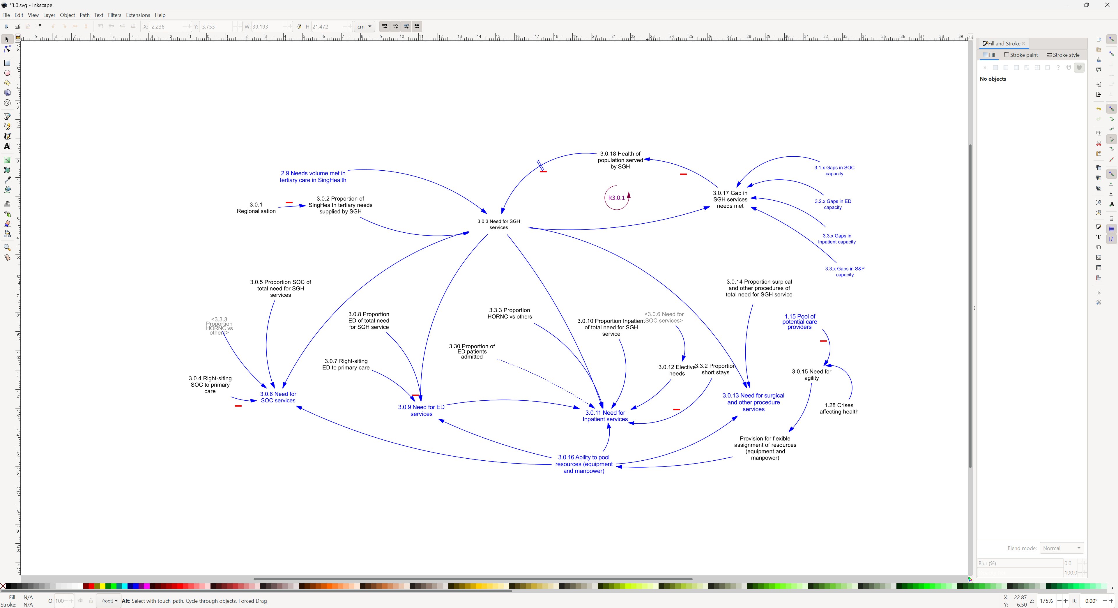

Can you email the model to us? The export to SVG works fine for me with the arrowheads on the comments working fine.

I'm confused. The SVG file you sent looks fine to me, I've attached a screen shot of the SVG file in Inkscape, what is missing from the model?Ashish_Kumar wrote: ↑Tue Oct 10, 2023 2:14 am The new version does solve the problem of missing arrowheads in the loop. However, it wasn't clear to me how one can control the zoom get an svg file that shows the complete picture.
The solution I am using now is as follows:
- Add blank text boxes on the top right and bottom left, leaving gaps between these and the rest of the variables
- Select all
- Print to pdf
I get the single, complete view that I need.
- Inkscape_screenshot.jpg (454.92 KiB) Viewed 5776 times

I just opened the SVG file by double clicking on it, and it opened in a browser, where the top and bottom were truncated (in both Chrome and Edge). It does work with Inkscape.
Thanks.
