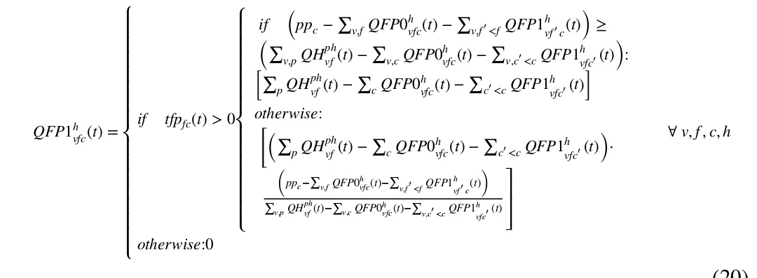

How to write this function in vensim?
Thanks in advance.
If then else function
- IMG_20231008_230454.jpg (71.87 KiB) Viewed 1467 times

Ugh.
The general framework will be something like:
QFP1 = IF THEN ELSE( tfp>0
, IF THEN ELSE( expression beginning with pp>0
,expression beginning with sum over QH
,expression beginning with sum over QH*fraction with pp in numerator )
, 0 )
It's pretty confusing subscripting though - I would strongly encourage making each summation a separate variable.
