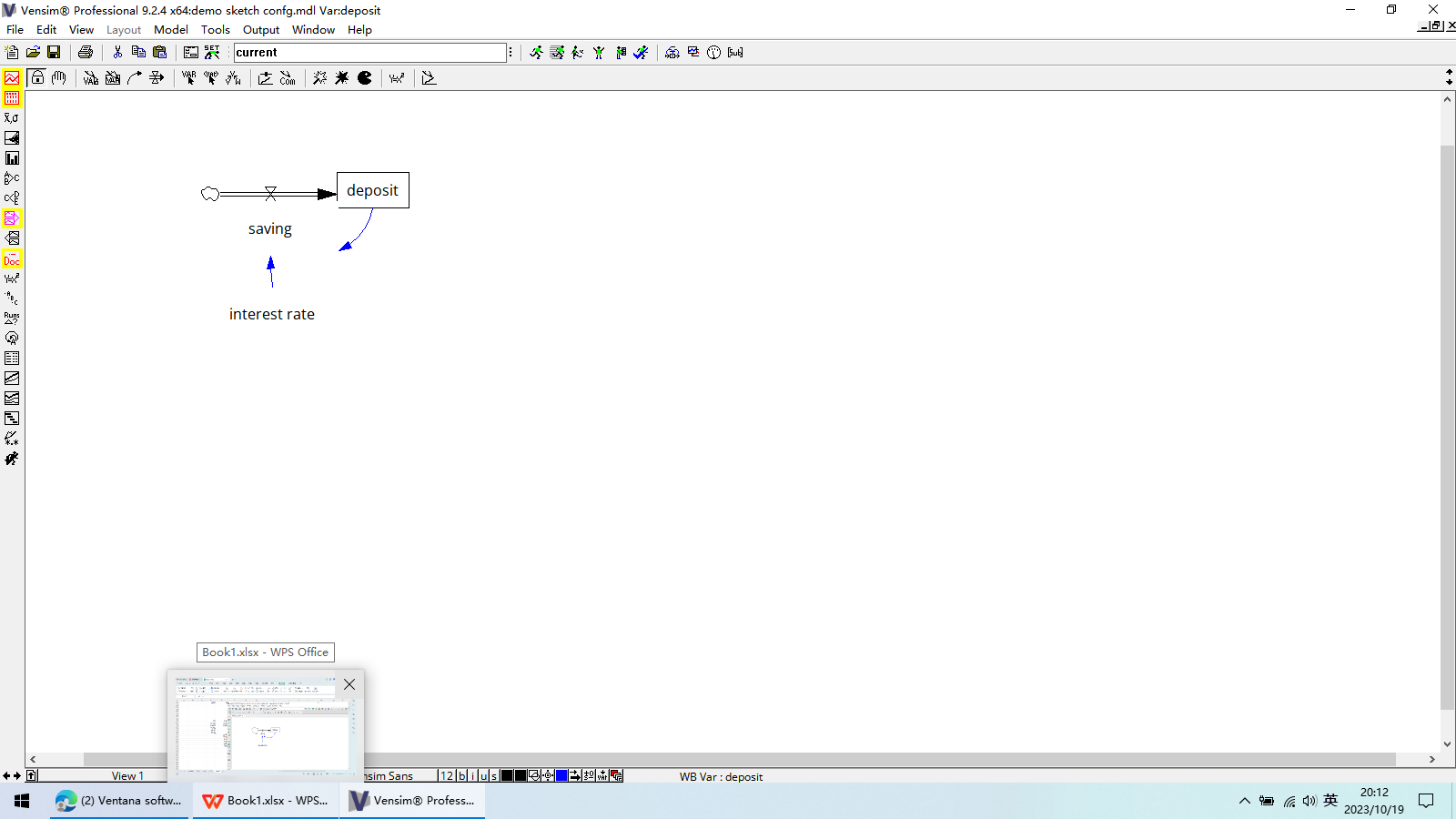

Re: impossible to switch back to the old gui a model built with the new guide
Dear
thank you for your quick reply.
firstly I realized a mistake about hide/unhide usage that I can find the "hide level" button under the option of each variable (click mouse right button)., so it is fine.
regarding the cloud size, it is always big in new gui when i sketch, but when i switch the drawing into old gui, the cloud size become very small. on the other hand, under old gui, the variable box size become bigger that the arrow not tightly linked. I attached the screens shot of the image for your advice.
for the sketch panel, I meant that in old gui, under the tool, there are sketch toolset and analysis toolset to modify, but under new gui, there is only analysis toolset to modify (see attached)
BTW, I found that i cannot hide the small behaviour graph during the Synthesim. see attached screen shot too
thank you
thank you
- small cloud size but bigger vairable box size afetr change frmo new gui to (old gui).png (72.55 KiB) Viewed 35448 times
- big cloud and variable box szie (new gui).png (88.44 KiB) Viewed 35448 times
- show behaviour synthesim.jpg (187.44 KiB) Viewed 35448 times
