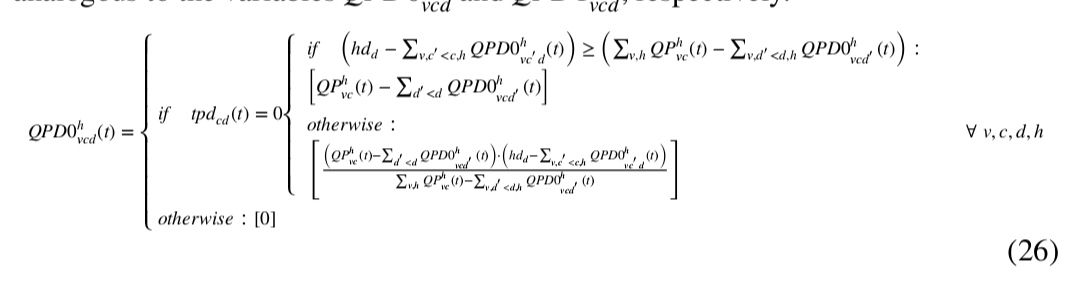

Re: Error Message
Actually I used the equation from this article for my college project.
That's weird for me too. I have no idea about it.
I asked my teacher and he said that might be a 'recursive function'.
Any ideas?

- Posts: 4834
Re: Error Message
All I can suggest is start at section 4.3 of that document and implement each equation 1 at a time.
It's not something I would want to do. It looks awful.

Re: Error Message
The subscript on QPD0 on the left side is vcd, and on the right side it's vc'd or vcd'. I'm not sure if the ' (prime) refers to differentiation or something else, but it's possible that the left and right side expressions are distinct things.
