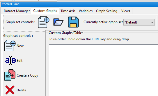

We use Vensim PLE, 10.0. After saving a model and reopen it, the coustum grafics are lost. You can see the grey areas, where they have been. But the definition doesnt exist anymoren. This has happend several times to a lot of students.

Here is an example. I made this simulation on Wednesday. As a open it today, there is a grey area only. The defintion of the custom graphs is lost.
