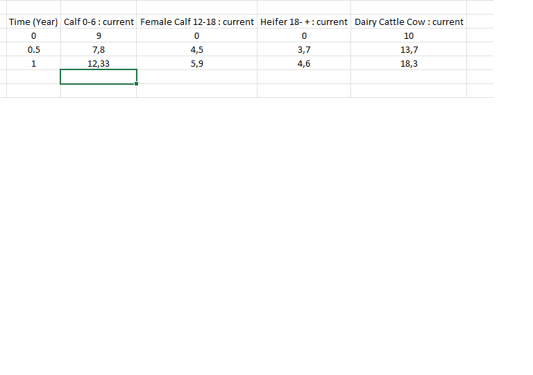

And i worked for control only 1 year
Result but it have to this For example number of calf have to decrace later 6 mounts and number of heifer 6-12 have to increace

Re: Lifecycle
I think your first step should be to adopt standard stock-flow notation in your diagram.
Currently you have no flows, so your are integrating earlier age categories directly into later age categories, like
This won't work, and produces the unit errors reported.
Bull= INTEG (
-Bull+"Bullock 12-18",
0)
Units: number
"Bullock 12-18"= INTEG (
"Bullock 6-12",
0)
Units: number
