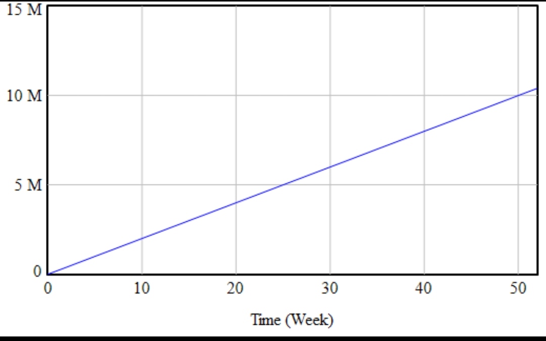

Let me tell you what I mean with an example.
Here we have a graph that shows the ceiling of 10 million.
I want Vensim to show it as a percentage as display 10 million in 100%

If the endpoint is fixed, you can use the approach of creating a variable.
If the endpoint is uncertain, specifically, not known at the start of the run, there isn't really a way to do this, except by postprocessing the output in some other tool (Excel, R, Python ...)
