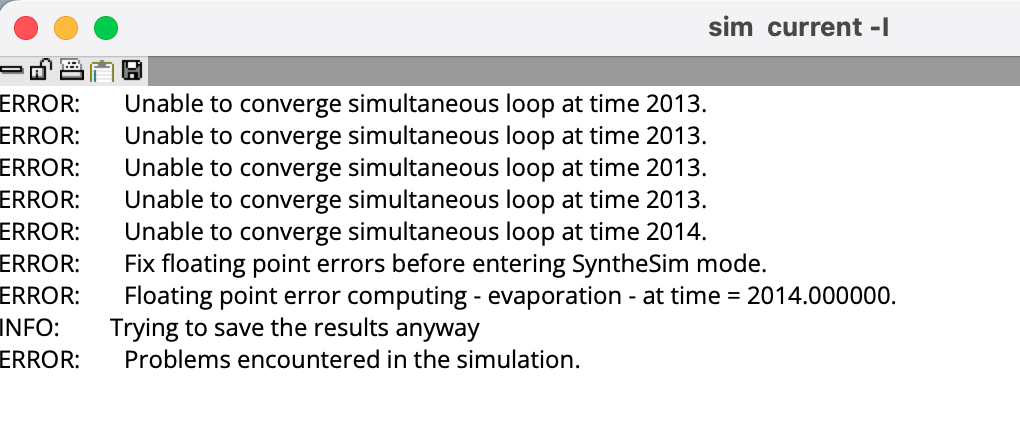

After running the simulation there are errors: Unable to converge simultaneous loop at time; and the floating point overflow error. Despite looking through the forum for a solution, I could not find one. Could you please explain how to solve the simultaneous loop time problem? And why does my "evaporation" variable report division by zero/overflow? Meanwhile, how do I execute the command "Partial Model Simulation"? Many thanks.
- Screenshot 2024-01-13 at 12.04.43.png (93.09 KiB) Viewed 5746 times

You've got some very basic errors in model formulation which is why I suggested going through the tutorial.
"Total surface water" should be a stock/level which increases via "Natural rainfall" and decreases via "evaporation". "Evaporation rate" is 36.9 (but this is dimensionless, so what is 36.9, it should be measured in litres/day or some other meaningful unit. "Natural rainfall" is also dimensionless (it's not in reality).
This model should not use the SIMULTANEOUS function at all. I don't think I've ever used it in a model.
I strongly suggest that you do a basic tutorial before you try doing something like this. These are very basic errors.
