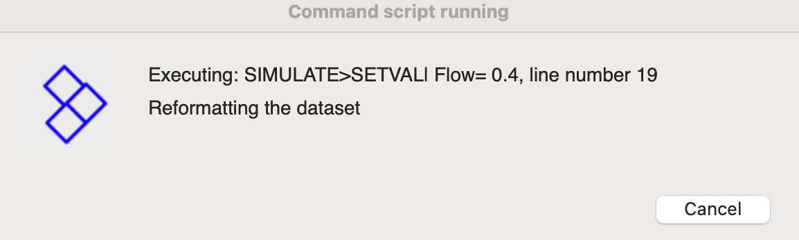

After updating to DSS 10.2.1, I cannot run the same cmd I've been using for the past few weeks on macOS. It feels that it gets stuck in a loop, and 'cancel' doesn't work (the OS doesn't say Vensim isn't responding). I have to force quit Vensim. I checked again, and the script works fine on DSS 10.2.0 on Windows (and it worked on 10.2.0 on macOS too).

Re: CMD script macOS problem
I couldn't figure out a way to make it 100% replicable, but I have a hunch that this issue happens when there are a lot of datasets in the folder (which is what I had in my original model).
A similar error was happening when working with my original model, and I thought there might be something wrong with the variable names. But it's now isolated. It gets stuck here and won't move forward. Vensim doesn't crash either. 'Cancel' doesn't work.

- Posts: 4844
Can you let us know exactly how you run the script? Do you start it via a terminal command or edit the CMD script and hit the run button?
- Posts: 210
- Posts: 4844
I'm rebuilding now, and will hopefully get an update to you today.
- Posts: 210
Thank you!
- Posts: 4844
I've updated the DSS Mac installer, it should fix this issue.
