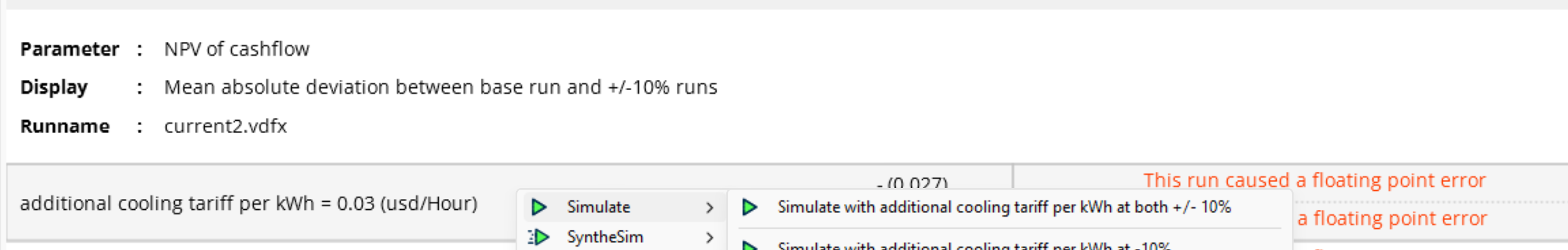

From the S2A screen, I chose to simulate 1 param +/- 10%.

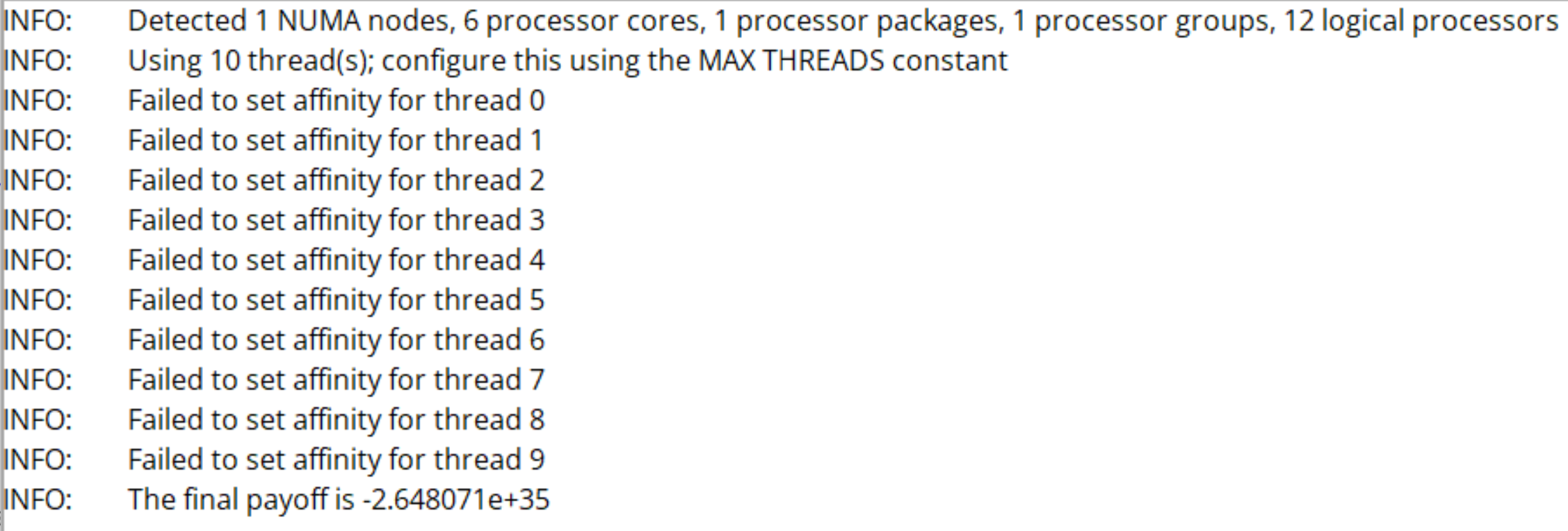

The result shows a series of failures.

I do not actually see anything different in return - I am not sure where the results of the simulation run go from selecting within the S2A bar. When I try to rerun S2A after that, Vensim crashes and closes.

The thread affinity warnings are benign. It just means the operating system declined to assign requested threads. Presumably this is Windows, where thread management is not as good as Linux. It won't affect results.
The crash might be related to the floating point errors in the model. Did you submit the crash report?

You should be able to replicate the error manually. Just do a run with the first reported problem, manually changing additional cooling tariff kwh as shown.
When you choose "simulate 1 param +/- 10%" it creates ordinary runs that will appear in the dataset control, on plots, etc.
