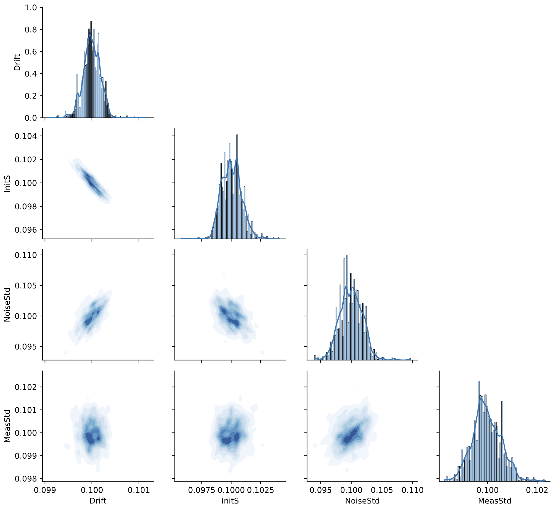

Is there a way to avoid sampling from parameter boundaries, apart from manually defining a penalty term in the payoff function? I am fine to get a uniform distribution if MCMC cannot recover a proper posterior distribution. By the way, I have not defined a probability distribution for the prior.

Thank you! It is a normal log-likelihood. I have attached the toy model here. These are great suggestions. I think defining a prior and including it (mean and standard deviation) in the payoff as the initial condition would resolve the issue. But I guess I should keep the barrier penalty.

What param are we looking at in the histogram?

Hi Tom, Sorry for not uploading the data. I have attached the whole folder here. I did a quick test with the boundary penalty, and it gave a me a very good result, though I added an additional parameter (Exp Sigma, which is not shown in the graph). I'll try to implement your suggestions. Thanks a lot!

I borrowed the boundary penalty formulation from a template that normalizes the estimated parameters, but I didn't properly adjust the equation based on the parameter boundaries I have in the model. So, I got it to work by accident. I'll share a revised version, though now I have some doubts about the template.
Re: MCMC Sampling and Boundary Penalty
I modified the hard bounds constraint behavior so the concentration of mass at the bound no longer happens, at least in a case like this with a uniform likelihood and (implicitly) flat prior over a unit hypercube.
