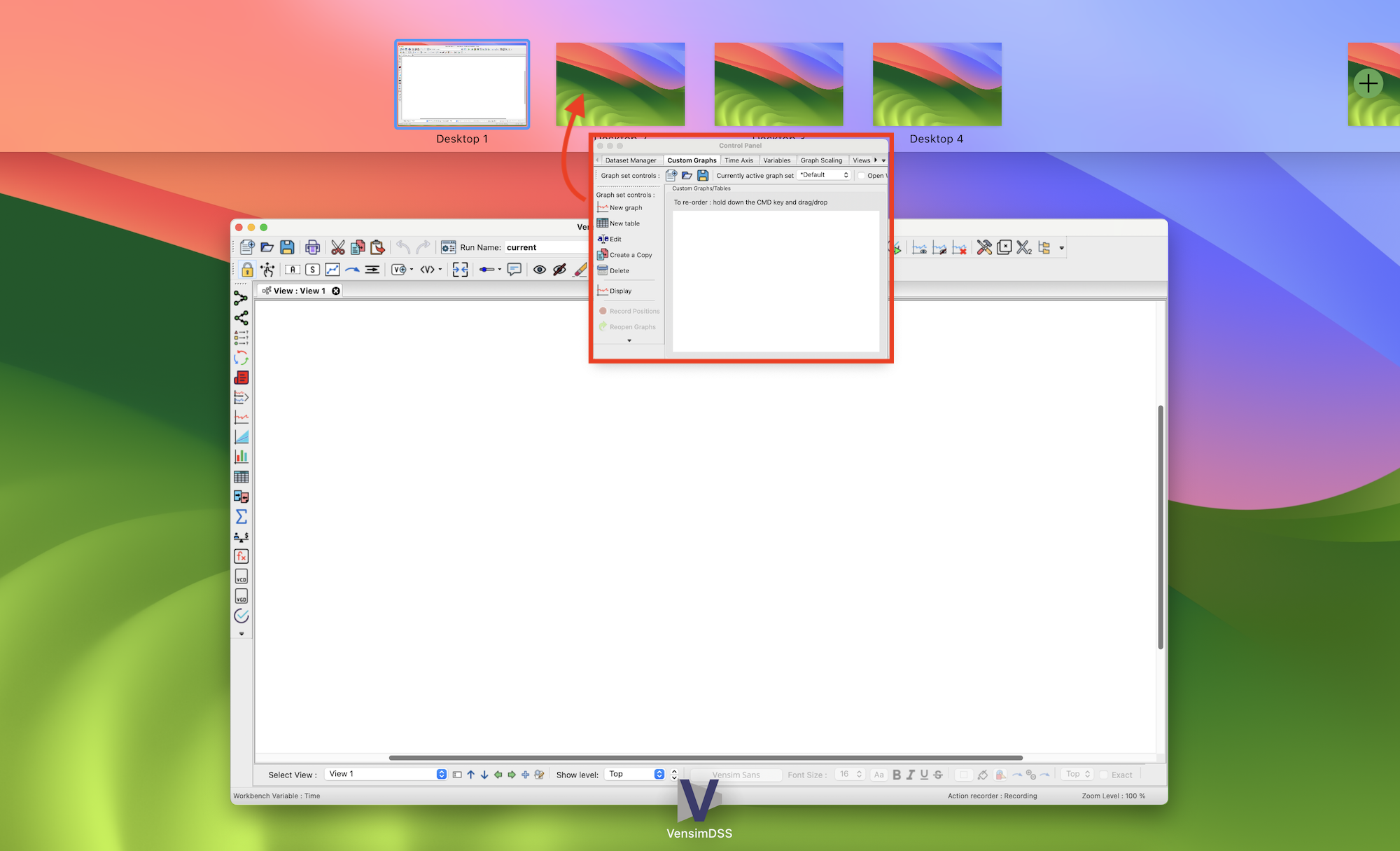

The only workaround I’ve found for this is to move the CP window to the 2nd display. After it disappears, go to Mission Control (Swipe up with 3/4 figures on trackpad) and drag and drop the CP window to the Desktop space on the 2nd display. Note that the CP window only becomes a separate entity and can be moved between spaces when it disappears by drag and drop in the first place. I think this behavior is unusual and should be improved in the source code.

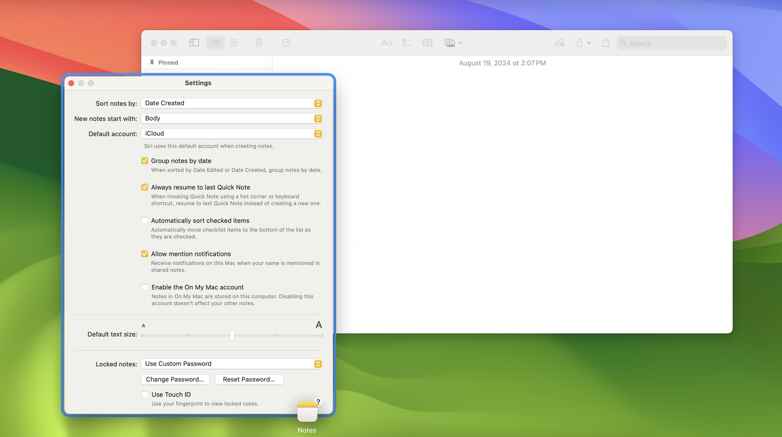

On another somehow related note, I mentioned above earlier that windows can be programmed to be considered as unique entities. I am here showing the example of the Notes.app where the Settings can be selected and moved to other spaces separately from the main window. It also doesn't disappear when other app sessions are activated (the example below is a screenshot from the Mission Control and the blue area indicates that the window can be moved individually).
