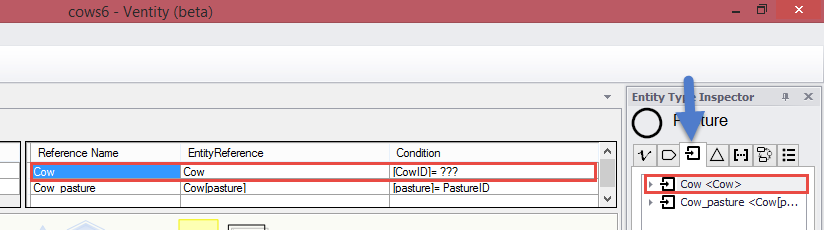

The cows6 model you posted has an extra "cow" reference in the pasture entity definition (see screenshot, attached).
Every cow needs a "pasture" reference, which cows6 has correctly formed.
Every pasture needs a reference to its collection of cows, which cows6 also has correctly formed.
But every pasture does not need a reference to an individual cow. The reference highlighted in the attached image may have been created by accident during the modeling process. Deleting it will solve the issue.
On our list of things we'd like to add is, clearer indications of when references are undefined and unused, as in this case.
Dan
Dan
