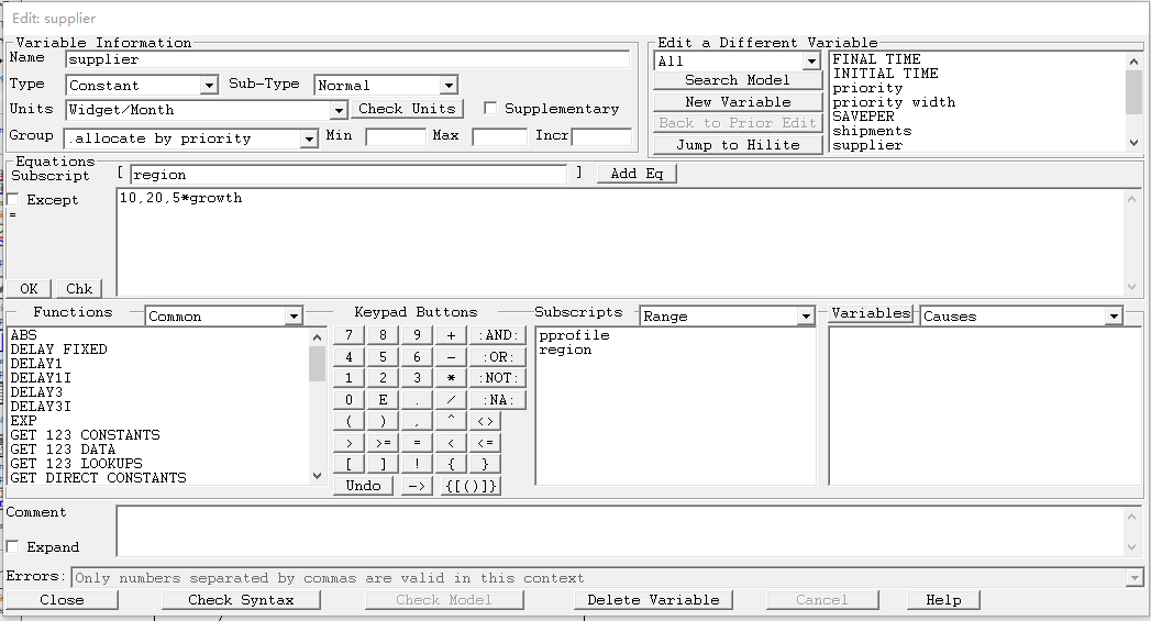

Because I rarely used subscripts before, I want to show the change in growth directly in the formula.
But, it said the error: ONLY NUMBERS SEPARATED BY COMMAS ARE VALID IN THIS CONTEXT
So, I was wondering how to solve it?

This attached model would mimic what you are say you want to achieve. There is a lot more that goes into modelling the electricity market. Good luck!
Do note that this is a quick job so I didnt align the units.
Reading the documentation and what others have posted before about these functions are very useful. Do note that priority component uses -Supplier Cost as highest value of what is sent into the function gets top priority.

The immediate problem here is that you can only use a comma-separated list for constant values (i.e. numbers).

Thank you very much. So sorry that I reply so late.JudeChen wrote: ↑Mon Nov 25, 2019 5:40 am This attached model would mimic what you are say you want to achieve. There is a lot more that goes into modelling the electricity market. Good luck!
https://www.vensim.com/documentation/fn ... ilable.htm
From your hint, I found solution. Thanks again.
