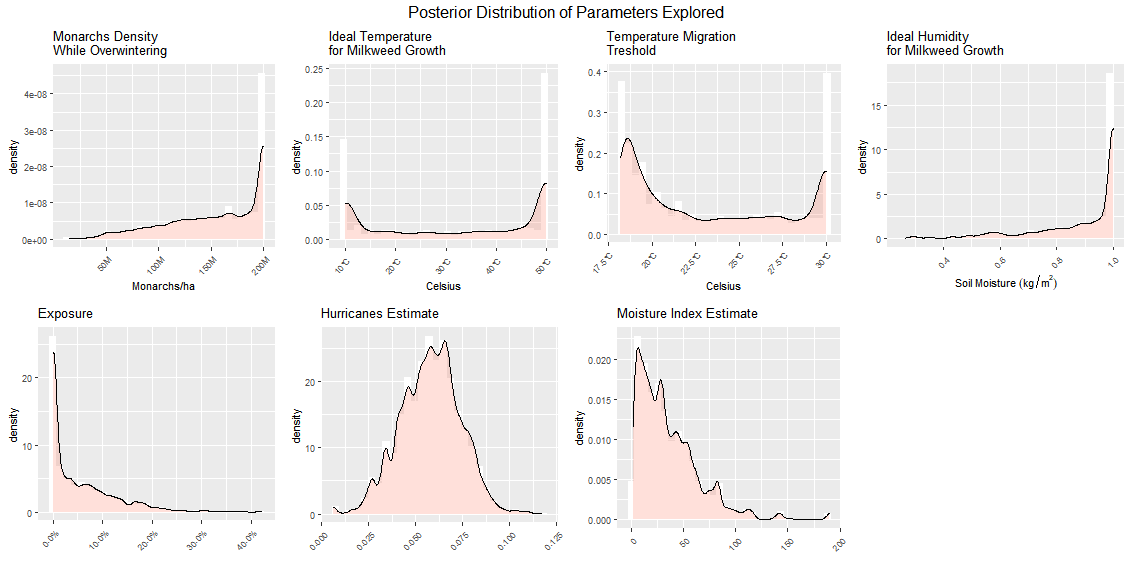

Hi, I have been running a model through MCMC to obtain the posterior distribution of 7 parameters.
The problem is that, if I set an upper and lower limit for the search range of the parameter, for example:
10<=Temperature<=50
the posterior seems to be getting 'artificially' oversampled in those limits. So, my histograms look more like a valley (edged by the search limits) rather than a bell curve.

How many parameters are hitting the boundary? Just this one, or several of the 7? (If several, it might be getting stuck in a corner.)

And yes, it seems that at least 6 out of 7 of my parameters are showing that same problem. You mention that it could be getting stuck in a corner. How to 'unstuck' it?

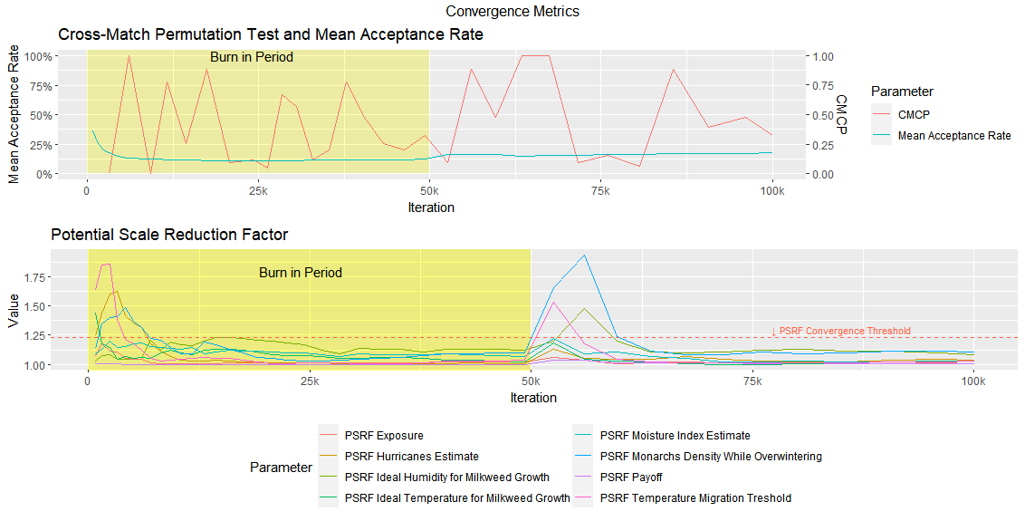

By the way: The convergence metrics with that odd-looking posterior sampling seem to be very good
