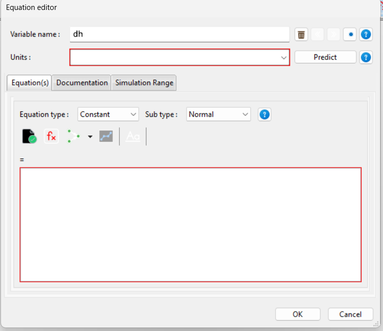

2) When I was using Vensim before, there were options to select predefined equation in the equation editor, which I don't have access to now. Additonally, the Lookup Function variable used to provide an option to input coordinates into a table to define the function, but now I can only add points on the graph without any options to remove points.

Re #2, when you say "predefined equation", are you referring to the function list? We removed that in favor of predictive typing.
However, the list is still there:

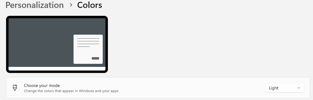

Hi,Administrator wrote: ↑Fri Mar 21, 2025 9:48 am Can you turn off dark mode and see if the icons are ok?
I have the same problem that on my Windows 11 Pro machine the toolbar icons are displayed poorly.
As suspected, the dark mode in Windows (not in Vensim) is responsible for this, as it activates the dark mode in apps.
This is what the toolbar icons look like with dark mode activated in Windows: And this is what the toolbar icons look like with dark mode deactivated in Windows: The dark mode is available in Windows 11 under ‘Personalization > Colors’ (chose either 'light' or #dark'): It would be desirable if the toolbar icons were legible whether Dark Mode is activated or not.
Best
Markus
