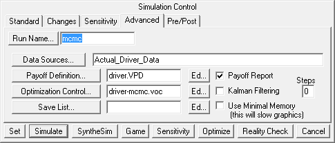

Re: Help with model calibration
Try running it from the simulation control dialog. The setup should look like this:
and the result should have no errors./*
Thanks so much.
I think I was not doing the right thing. Please, find attached the steps I went through.
How did you get the set up you sent me?
