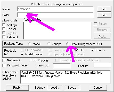

You need to develop the Java application on the machine that has Vensim installed. Giving the DLL to someone else will not work.
When you have your application running, publish the model using Vensim. Make sure you select "Other" as the package type, and in the "Caller" section, enter the command you use to launch Java and click "Publish". Now run the model reader, click File->Open model and select the model you published, the model reader will launch Java with your model.
