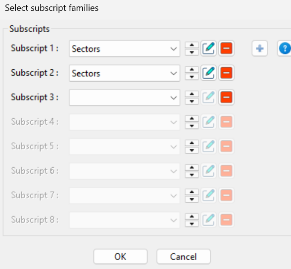

According to this section, it is possible to select ranges that under the same subscript multiple times. I am trying to do this with the subscript Sector in my model with range [Pharmaceutical Industry, OtherSectors](i am coding it like this because I would like to potentially upscale this to other sectors). However, when I try to do that, my model gives the following error:
Duplicate Subscript Families Found (Sector)
The goal of this code is to assign a number to each pair (sector, sector) when sector ≠ sector
Attached is the model I am working with and a screenshot of my error. Could someone kindly advise me on what I could do to get to the final result?

Re: Multiple Equations for a Subscripted Variable HELP
You've found a glitch that will be fixed in the upcoming release.
You can't literally write,
Price[sector,sector] = blabla
but you can define subscript equivalents,
fromSector <-> sector
toSector <-> sector
and then write,
Price[ fromSector, toSector ] = blabla
However, the equation editor glitch currently forbids this. A temporary workaround is to switch to the text editor. There you will find something like:
Price = A FUNCTION OF( blabla )
Price =
~ unit
~ doc
There you can modify it to have the proper subscripts on the left side, like
~ unit
~ doc
When you switch back to sketch view, the editor will be OK with that. Sorry for the temporary inconvenience.
