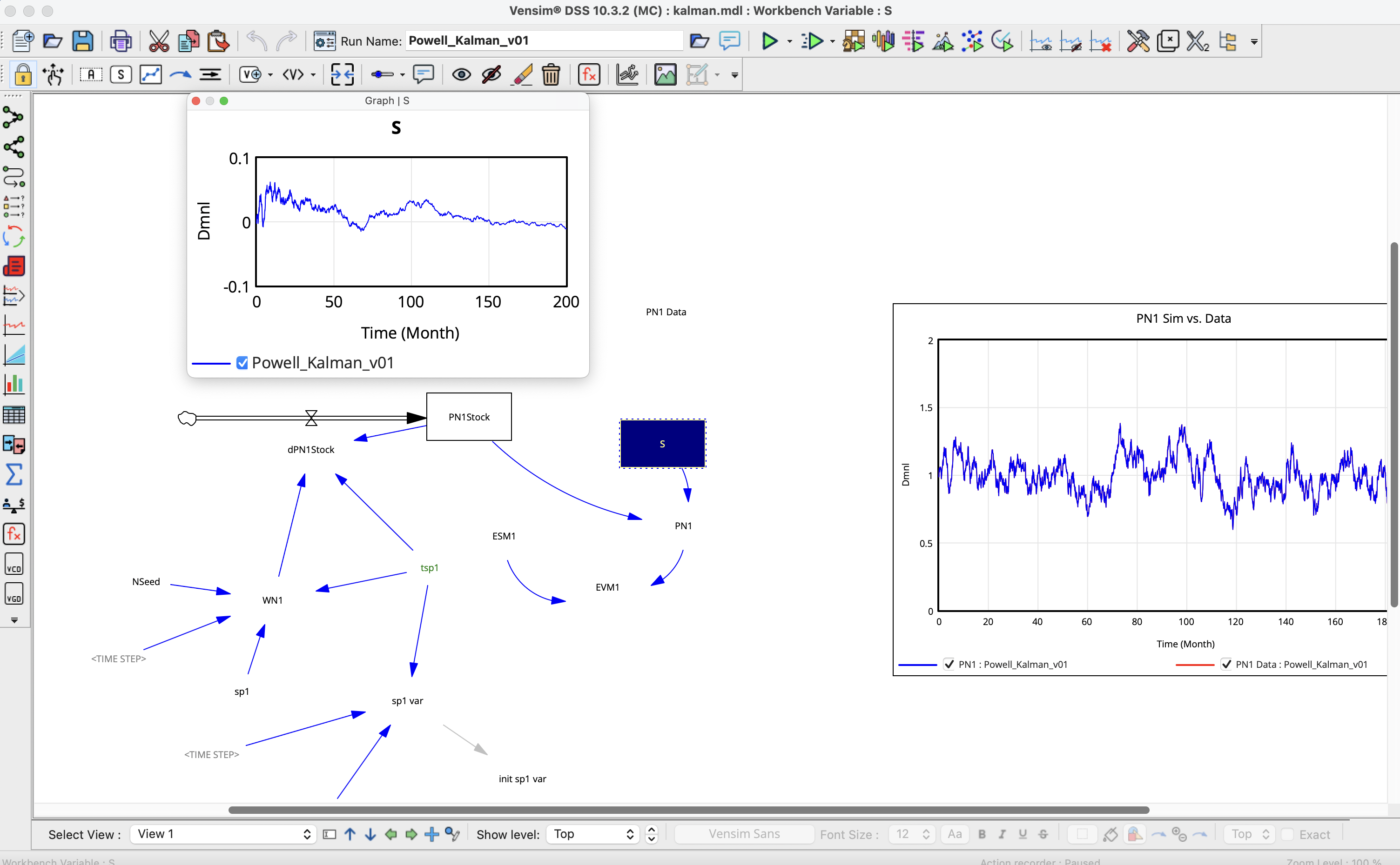

This is similar to the model I've shared earlier (viewtopic.php?t=8552). I've noticed that state resetting is applied to all stocks, not just the one I define in the '.prm' file (PN1Stock/sp1_var/init_sp1_var). In these situations, how do I prevent a random stock 'S' getting changed because of the filter?
How do I narrow down the impact of filter?

You could set the driving noise for that stock to a very small value (not 0).

Re: How do I narrow down the impact of filter?
I think 'S/1e-10/1e-10 is enough.
The default assumption for off-diagonal covariance is 0. You only want to specify this term if there's plausible correlation between the noise affecting two states, which is not that common.
The issue seems to be that when you leave off a stock from the kalman.prm file, Vensim assumes the initial Var for that stock to be 1, and the driving noise var to be 1e-6 (this is based on a quick comparison on a simple model like the above). I don't know if this assumption is well documented in the help, but could be consequential if people are not aware of it. It also requires one to add all non-affected stocks in the prm file with very small variances for driving noise/initial variance, which is a pain.
