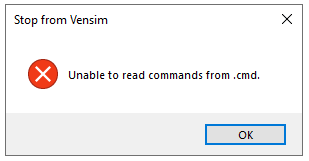

I'm using Vensim DSS 10.3.2. I'm trying to run a command script through a .cmd file and either a .bat file or a VBA script to launch Vensim. However, when Vensim launches, this error message appears:
When I open the command file directly in the Vensim interface via 'File > Open Model', the simulation runs without any issues.
I don't understand why this error message appears when I try to launch the command file outside of the Vensim interface.

That looks like you are passing a blank filename to Vensim. Can you debug you vba to see what you are actually running?

I've checked my VBA code, and it does refer to the name and path of the .cmd file that I tried to launch. As this did not work with a simple .bat file either, I don't think the error comes from my VBA code.
I've tried this line of command in my .bat file
START C:\PROGRA~1\Vensim\vendss64MC "test.cmd"

Can you upload your test case?
