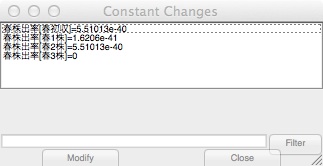

Using Constant Changes in Venapp
Constant value is shown in dialog(like attached pic1;5.11a).
But only Model Reader in OSX 6.0,
it show 0 or some big value.(like pic2;6.00)
Both is running same vpa file.

- pig2.jpg (17.67 KiB) Viewed 3815 times
- pig1.jpg (15.38 KiB) Viewed 3815 times
