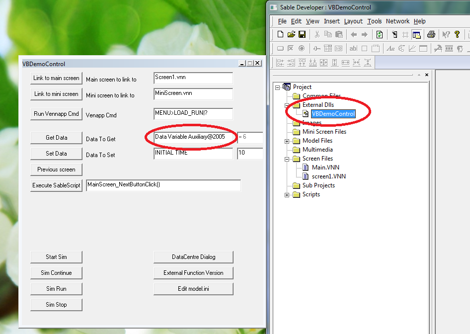

Re: Getting and setting variables at a given time
I open the project with Sable Developer, then run the DLL VBDemoControl in "External Dlls" folder. In DLL's window, I try to get data.
- get_data_variable.png (234.2 KiB) Viewed 41110 times
- Posts: 4865
I'll have to raise this as a Vensim bug, I have no workaround for now. Sorry.
