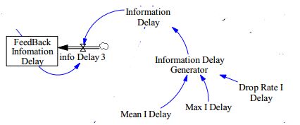

In this particular model, what could be the equation for " Information delay generator" ?
the author mentions in his article something about "negative exponent". What is exactly a negative exponent in Vensim ?
I cite a part of this article :
"So first we use a negative exponent in generator to depict the main tendency of delay, its index points out how quick the level drops. Then we add a uniform random on it to depict the fluctuation. These two generators have the same structure, one for the Transport Delay, the other for the Information Delay."
I attached a picture of this structure.
- Capture.JPG (18.16 KiB) Viewed 13491 times
- Posts: 4865
Re: Problem in Reconstructing System Dynamics Models
My guess is that "Information delay generator" is a random number.
http://www.vensim.com/documentation/ind ... random.htm

SO I managed to find out what is this information delay generator. It is a negative exponential function, and it is uses the EXP + LN + LOG.mdl in FunctionExamples. I attached the model to this post.Administrator wrote:My guess is that "Information delay generator" is a random number.
another issue is that, in this model, two variables (Average Lead Time, std Lead Time) has input of (INITIAL TIME, TIME STEP, Time, Feedback Lead Time ). these variables are colored in green in the model. What could a possible equation for calculating average lead time and std lead time ? any idead?
