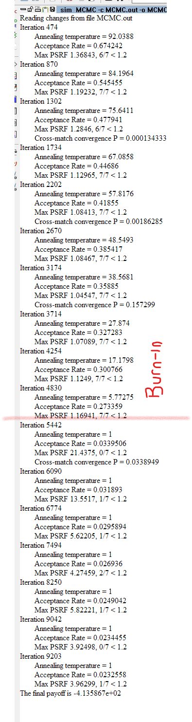

Hey Tom, I already ran sims with and without annealing, and with and without the burn-in period, but I still see the same; as soon as the samples begin to get drawn, the stats move from an almost-ideal position to an awful one.
I also made some runs with SA and making sure that temp goes down to 1 before sampling; still when the samples start to get drawn is when things go bad (see image)

Re: Help with usage of MCMC
It looks like your cooling period is longer than your burnin period, so there's an abrupt drop in temp from 5.77 to 1. I'd try changing the lengths so that doesn't happen, or just turn off the cooling altogether (you may find that you don't need it anymore).
