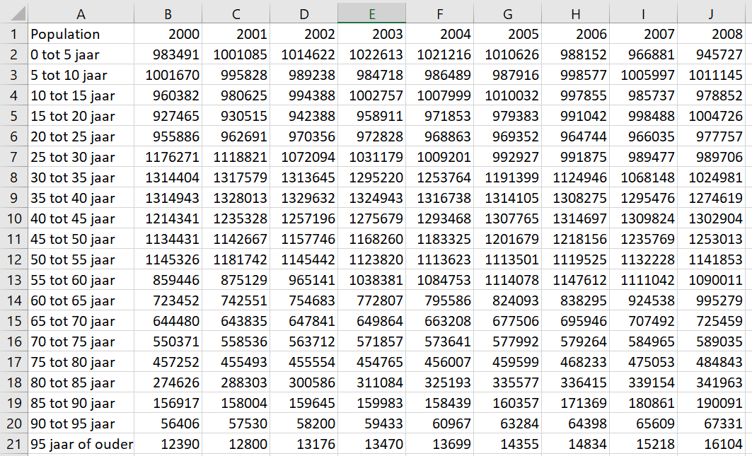

I want to use subscripted lookup and tried using GET DIRECT LOOKUPS, but didn't manage to get it to work.
Basically I have a table in a CSV with years (time) on the horizontal axis and different age groups (which I want subscripted) on the Y-axis. I load in subscript values into a variable age_group using:
GET DIRECT SUBSCRIPT('data/population_data.csv', ',', 'A2', 'A20', '')
I tried using GET DIRECT DATA with the subscript in population-pyramid-submodel-2.mdl, which doesn't load the data correctly over time. So I tried using GET DIRECT LOOKUPS subscripted, but that crashed and after that the model (population-pyramid-submodel-2.mdl) doesn't even open again.
So is it possible to load in lookup data subscripted? If not, what would be a work around? If so, how do you do it? If with GET DIRECT LOOKUPS, could a subscripted example model be added?

I managed to fix it and use a GET DIRECT LOOKUPS with a subscript!
Could maybe an example model be added to the GET DIRECT LOOKUPS documentation? Since I believe it's non-trivial since you also have to define the subscript range with GET DIRECT SUBSCRIPT.

For the '2' version of the model, there are two issues:
- time axis of the model doesn't match the data
- function call is wrong: time is in row '1' not '2'

This doesn't crash in 9.2, but doesn't run either. When I look at it with a text editor, I see:
{UTF-8}
age group : GET DIRECT SUBSCRIPT ,'', 'A21', 'A2', ',', 'data/population_data.csv', 'data/population_data.csv'\
        'A2',
        'A21',
	~	People
The function's parentheses are missing, and it seems like there are too many arguments.
Posts: 4025
Re: GET DIRECT LOOKUPS with subscript
When I correct that to
age group : GET DIRECT SUBSCRIPT( 'data/population_data.csv',
        'A2',
        'A21',
	~	People
It works in 9.2.
