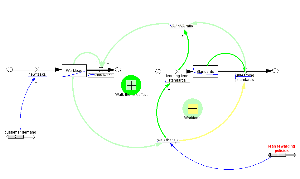

Stuck in my own mental model
Dear fellow dynamicists,
a while ago I have asked about how to build a "moving target" into a VENSIM model.
After I have reflected for quite some time trying to cope with the challenge there still is glimpse of puzzling as the model doesn't behave as reality shows.
The model will be attached to the post and it is about sustainable change of a "lean implementation". This will be affected by appropriate rewarding policies and the actual workload that is coming.
I am very grateful to any helping insight in this tough question (at least it looks like that to me!).
Thanks a lot and cheers
Ralf

Hi Ralf
I have well received your model by mail.
Il looks very strange.
First it has unit errors which probably is a result of the strange equations in it.
I have never seen levels that have as input the ratio of the input by the output. What does it mean? It should be
integ (input - output and not integ (input / output
Why is the variable VA/VNA ratio a difference and not a ratio? This is misleading.
What is exactly the level standards. Is it the applied
lean thinking standards?
What is exactly the walk the talk ?
I do not understand why the workload has a negative influence on the learning and a positive on the unlearning.
I do not understand the va / nva ratio. What is it?
What variables do you find not behaving properly?
Can you formulate your model in plain english, explaining clearly what each variable is representing, and why is one variable influencing another one?
Regards.
Regards.

Here is the model as viewed in VENSIM grasped as a picture.
Especially the non-change of WALK-THE-TALK, especially when the REWARDING POLICIES are changed appropriate to foster the Lean Culture?
Regards
Ralf

- MEDIA_MOD_080606_Lean_Culture_1.png (17.19 KiB) Viewed 18192 times

Here comes into play what hinders almost any system dynamics project/thinking (coming from the bottom of the organization):
Do I get a promotion, if I get involved into the project?
We can't change these set rewarding policies as we are not HR!
This makes it even more difficult to understand the different drivers and in which way (equations) they are connected in the model.
The Causal Loop Diagram looks pretty straight forward (at least for my eyes;-)) and the most challenging part of the transfer to a "working" model is to find the functions that emulate reality closely enough to see current reality (in the reference model run!).
Any comments and questions are very welcomed:-))
Cheers,
Ralf
PS.: How to split the given model into submodels which can be analysed seperately and then could be put together to run as a larger one?
Ralf Lippold
Hi Ralf
It is difficult to split reality in piece especially when the parts are related to each other, through feed back loops.
To make a model understandable, I start with a simple model, eventually with one level,
and try to understand it fully by using it with all its different possibilities.
It is then easier to get to a slightly more complex model and to use it again fully and so on.
I have just finished a model that has unfortunately 130 loops and I have not enough studied the earlier easier versions and I am too lazy to start studying it fully with the lack of experience of the earlier versions. I have a model that I can use but I do not really understand it fully and intuitively and I am therefore not completely confident with the results it delivers. To bad. The next model I build, I will try to follow strictly the method.
Regards.
[Edited on 14-6-2008 by LAUJJL]

Hi Ralf,
You might start with a project model - eg Richardson & Pugh prog.mdl in the others directory). Add to that an input to quality based on training in quality management principles so that you add to fraction satisfactory a new effect
fraction satisfactory = normal fraction satisfactory*
effect of experience on fraction satisfactory*
effect of schedule pressure on fraction satisfactory *
effect of training in quality management
where
effect of training in quality management = etqf(retained training hours / reference retained training hours) ~ dmnl
eftqf((0,0),(1,.9),(10,1)) ~dmnl
retained training hours = INTEG(training hours - forgetting training,initial training hours) ~Hours/Person
forgetting training = retained training hours / time to forget training ~ Hours/Person/Month
then you can experiment with investing time in training versus just having people trying to do work to see how that changes things.
