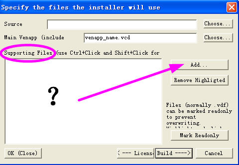

what supporting files Venapp installer builder need?
Example:
C:\Program Files\Vensim\models\sample\URBAN
The introduction of Venapp installer builder in DSS reference Supplement is“The Venapp Install Builder is a utility program for creating installers for . The Venapp Install Builder is included with the Vensim Application Distribution license.”

The supporting files required depend on the application. Normally they would include .vgd files, perhaps some .vdf files, some .cin or .gin files and some .xls file - you will need to check with the person who created the Venapp to get them all.

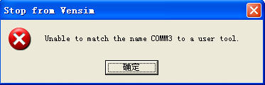

but after installation,it shows:
lynchyml
Posts: 70 Joined: Wed Aug 26, 2009 8:36 am
Post
by lynchyml » Thu Mar 25, 2010 1:09 am
and

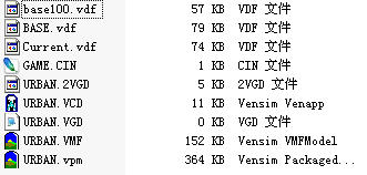

Does the the supporting files need to be sorted ?
If they need, how it should be?
lynchyml
Post
by lynchyml » Thu Mar 25, 2010 1:13 am
example files

If you are testing this on the urban dynamics game then all of the files that install with this are required so the supporting files would be
"BASE.vdf" "base100.vdf" "GAME.CIN" "URBAN.VGD" "URBAN.VMF"
The COMM3 report is defined in URBAN.VGD. If you got the message you have shown you should have received a message unable to open urban.vgd.
