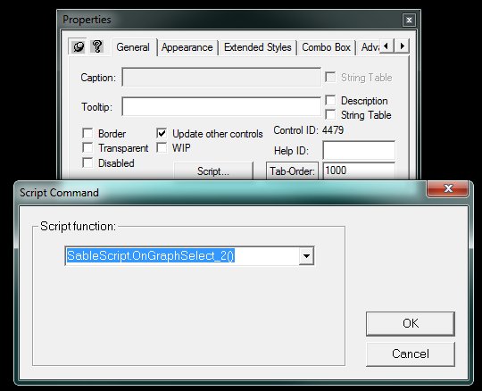

Getting there. I've managed to get a drop box calling up the different graphs I need by using the script in the demo you sent as the template. I then tried to get a second combo box to call up a different set of graphs but with no luck. I tried this two ways:
Firstly, I simply did a copy and paste of the two sub-routines replacing the relevant data ID number, combo box names, mini screen names etc.
Secondly, I tried inserting the new information INSIDE each sub-routine by creating ID1 and ID2 i.e.
nComboBoxID1 = 4385
nComboBoxID2 = 4479
In populating the combo boxes I had:
call SetControlProperty(nComboBoxID1,"ResetContent")
call SetControlProperty(nComboBoxID1,"AddString","Rate Requirements",1) etc...
call SetControlProperty(nComboBoxID2,"ResetContent")
call SetControlProperty(nComboBoxID2,"AddString","Rate Requirements Current Year",1)
I then used the same logic for the GraphSelect.
Neither strategy worked however so if you could give me some directions I would, as always, be very grateful
David

Are you using the default text editor in the Mac? If yes, don't, use something like TextWrangler (the one that comes with the Mac is useless).
When I opened the script file, I saw the following.
The Mac editor has not put in the correct line breaks after "exit sub" which means the function is not read properly. It should be
TextWrangler is the best free text editor I've found on the Mac.
Second problem is that you have two functions called "OnGraphSelect". Sable will always call the first one. So rename the 2nd one to be OnGraphSelect_2 (or something more meaningful)
You also need to configure the combo box to actually call the script. View the properties for the 2nd combo box, click the "Script" button and select OnGraphSelect_2.
All should now work as you expect.
Tony.

Re: C-ROADS INTERFACE
Thanks Tony
Yes I was using the default txt editor - I'll get the one you recommended and then have a go a re-doing it.
I'll let you know if I have any problems.
David
