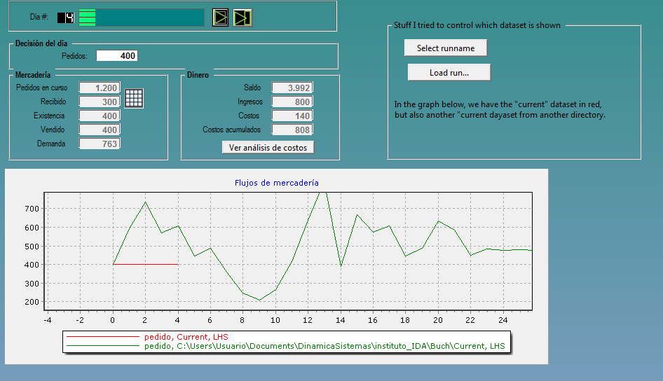

When you open the project file, the screen looks like in the screenshot below: In the graph, there are two datasets, one in red (this one is OK), the other in green (and I want to get rid of it): it belongs to the "Gobernator_spanish 3"-model, and I do not understand why the graph component displays it.

When you published, did you have any runs currently loaded? If yes, try unloading them within Vensim and re-publishing.
When published, a model retains a link to the runs that were loaded (and so they will appear in the graphs if the run is on disk). When I run the project, I don't see the green line.
You could also try running a SPECIAL>CLEARRUNS| as an activation command on the screen. That way, any existing runs would be unloaded when the project loads.

Thanks a lot,
now I understand and it worked!
