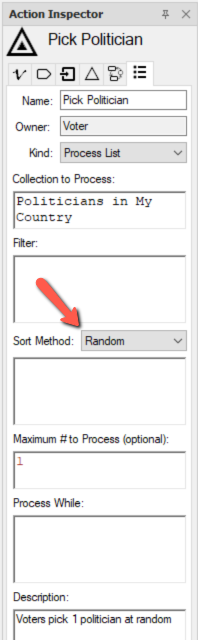

This turns out to be a pretty tricky task. A solution is attached.
The Process List uses an internal stock as a local counter to determine whether it's processing the winner (count=1) or a later loser (count>1).
Voters also use a Process List to pick a politician to vote for (currently at random).

This is fantastic, thanks. Looking it over, it's such an elaborate workaround that I can't understand it yet.
One understanding problem is I don't see where a voter's election choice is randomly set. This would occur in the Pick Politician action. Here refPolitician.PoliticianID is used to set Parent.politician supported. I don't see any randomness here. I even searched the entire set of folders for the model for the word "random" with no results.

Re: Unable to determine the winner of an election process

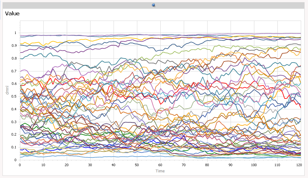

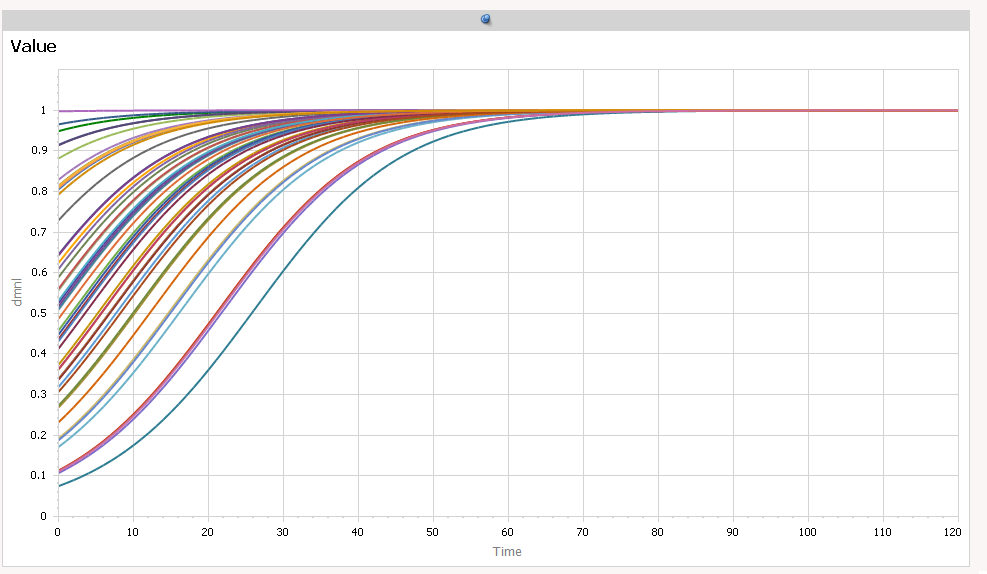

- Ventity Graph of Value not randomized.png (117.55 KiB) Viewed 48476 times
- Ventity Graph of Value.png (306.96 KiB) Viewed 48476 times
"brate" is short for "b rate" - i.e. a rate constant named 'b'.
What you're seeing with randomness off is the logistic model, dx/dt = b*x*(1-x). Since x,b > 0, it can only go up. The RandomNormal turns it into the logistic transform of a random walk, bounded between 0 and 1.

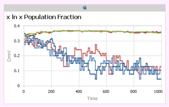

I love this example. In Tom's example model, a Person's Value varies between 1 and 0. We can think of the extremes as pro/con, right/left, red/blue, etc. The change function has the tendency to "polarize" the population, as evidenced by the thinning out of the middle quintiles.
We can normalize the quintile populations by the total population to get the population fraction in each quintile, x. We could calculate an information theoretic measure like entropy (S = -sum_i x_i ln x_i, where i is the quartile index).
In Ventity how would we perform this sum? (I can't see how to do an Aggregation of an Aggregation).
It's true that you can't currently aggregate an aggregate, because we don't have collections of collections.
The workaround is to map the subcollection values back to a regular entity, and aggregate that. In this case, you could map the value by [quantile] counts back to the Quantile entitytype, compute the pln(p) component, and sum in the Quantile[] collection.
I should note that I think I called that entity "Quintile" but it's not what we normally think of as a quintile. The cuts discretize the value distribution into uniform cuts, but the population of each group is not uniform. A real quintile would be rank based, with the cut points varying such that each group has the same share of the population. That's also possible, but not what I did. So, some other name - maybe just "State" - would be better.
