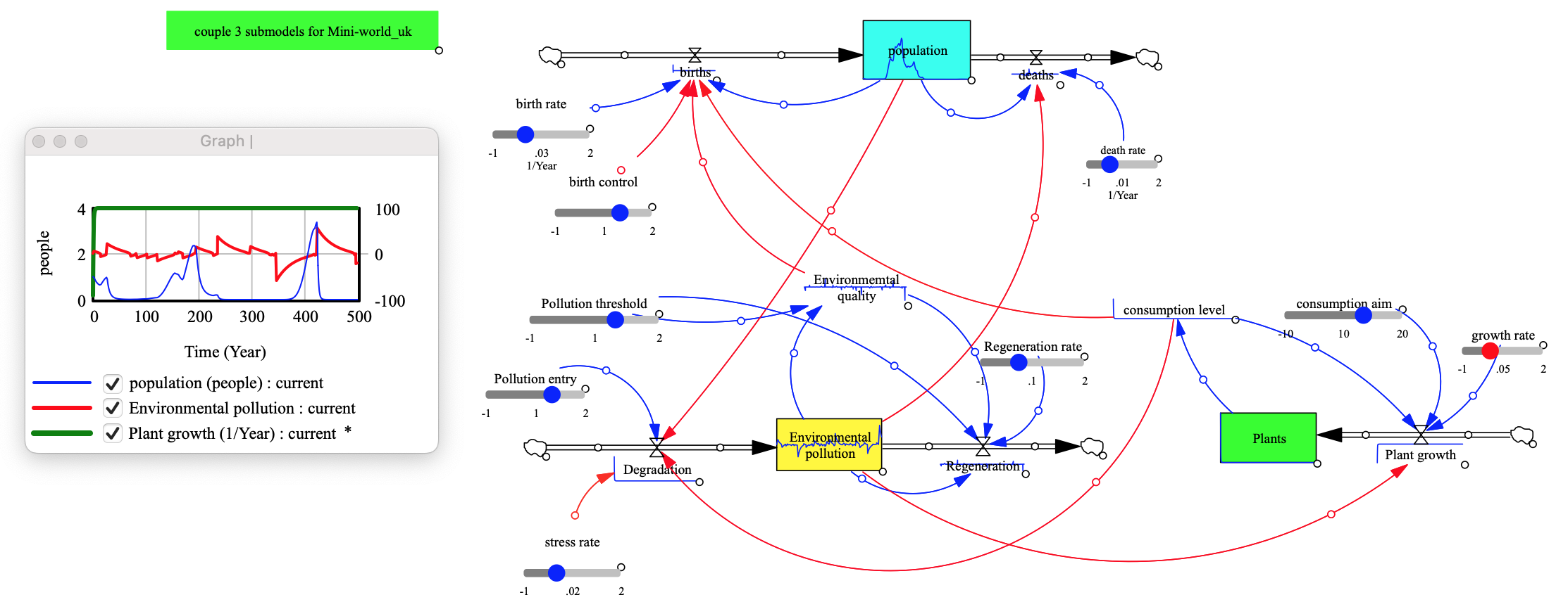

I cannot change the custom graphs "mini world" by using sliders.
Somethink is missing. But what?
regards
U. Küppers
Bildschirmfoto 2024-03-20 um 12.34.28.png (359.61 KiB) Viewed 24064 times
coupled submodels 1-3.mdl
(5.87 KiB) Downloaded 1178 times
Posts: 4027
Re: it is frustrating!
Is the run "current" the first loaded dataset?

yes, "current" is the first loaded dataset. I changed the run-name but nothing happens!
Perhaps a setting is missing in control panel?
Regards U. Küppers
Posts: 4865
Try the attached.
coupled submodels 1-3 (2).mdl
(6.16 KiB) Downloaded 1310 times

Thanks for the solution (3 curves in one graph). It works.
But for my understanding its better to know: What dit you concret change, so that the graph with 3 curves runs?
Regards U. Küppers
