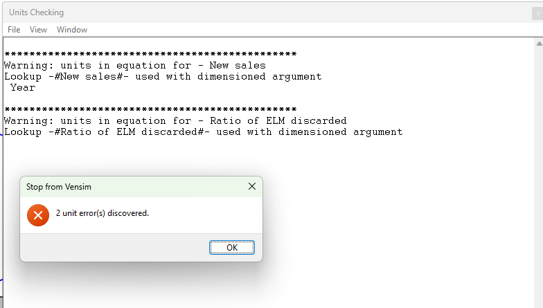

I am trying to solve the unit errors with such variables (I attached the model to this question).
How can I solve the errors I have 2 erros as the picture attached.
Thank you.

Re: Unit errors with LOOKUP
Those are actually warnings that you have passed a variable to a lookup that has a unit.
Traditionally, lookups are supposed to have a dimensionless X axis.
The following help entry details what you can do.
https://www.vensim.com/documentation/22280.html
